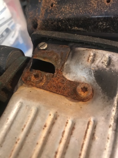

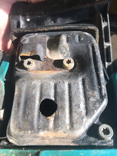

Replace the stock outlet with two slanted pipes and make it a four-shooter?! :cool:
That about how I do it... if I’m going aggressive. I already had a large torch tank set so it was easy to pick up some silver soldier and a Chinese jewelry torch of eBay.

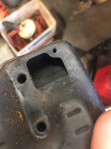

That mod may need a cover/deflector to direct gasses/sound to the sides to be bearable to the operator. o_O
May be but I stood behind the saw opposite of the direction of the noise...
So what I did was to close the bores in the inner shield that were reachable through the outlets to prevent a direct unbent stream of gases. That did help a bit but by far not enough so I closed the second outlet all together but widened the main one a little further.
This way the muffler now serves my 115iH which is one of my main work saws. The noise is OK now and the saw has gained significant power.
