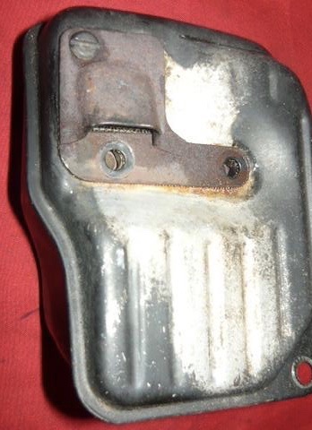

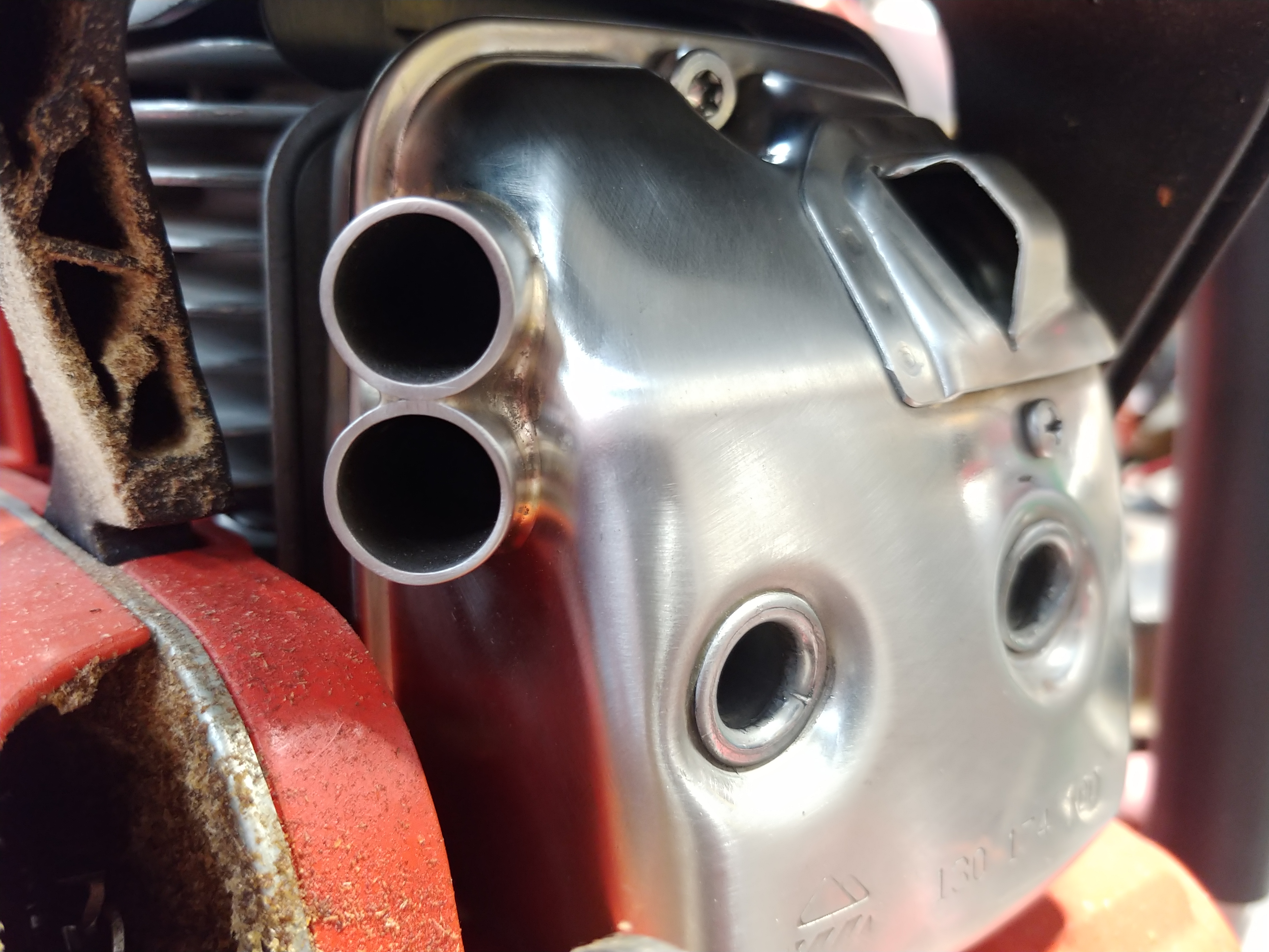

If yours has a one-arm-hinged flag then its early and parts are very difficult to find.
The mid and late variants are completely interchangeable, the only difference is the
desing of the outer cover which looks "curved" in late style as opposed to the more edgy mid style.
Between both all parts as well as the entire cover are interchangeable and as Wilhelm
stated before still in stock.
