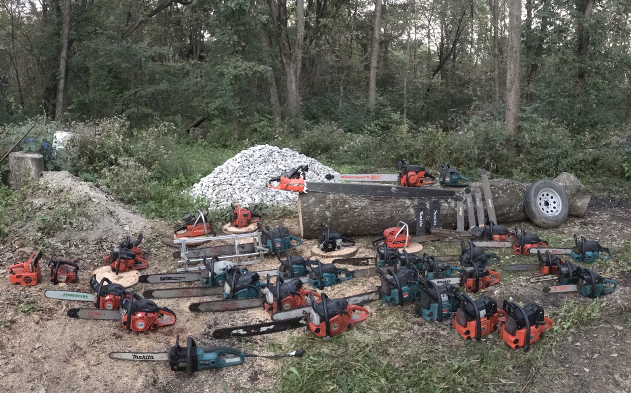

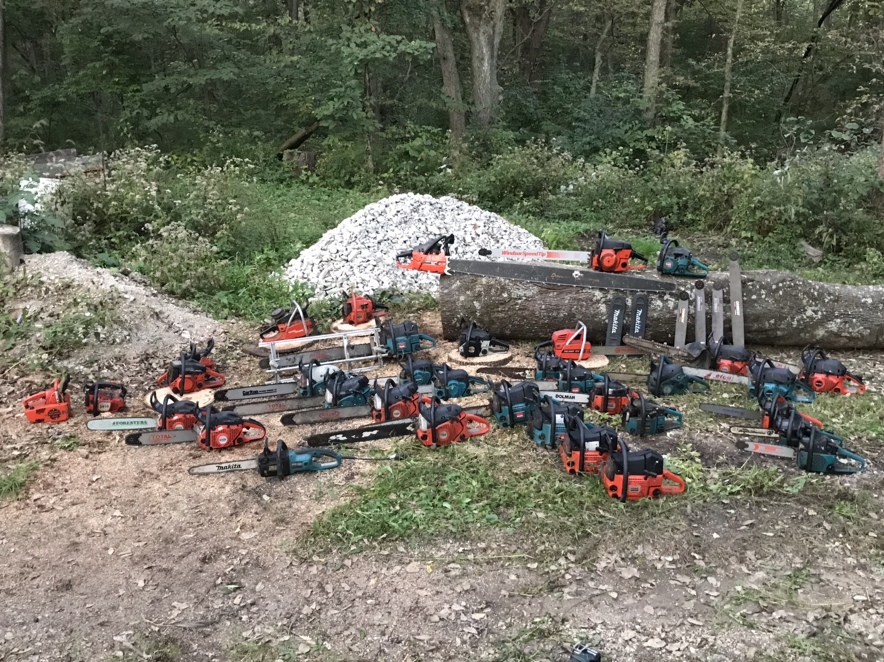

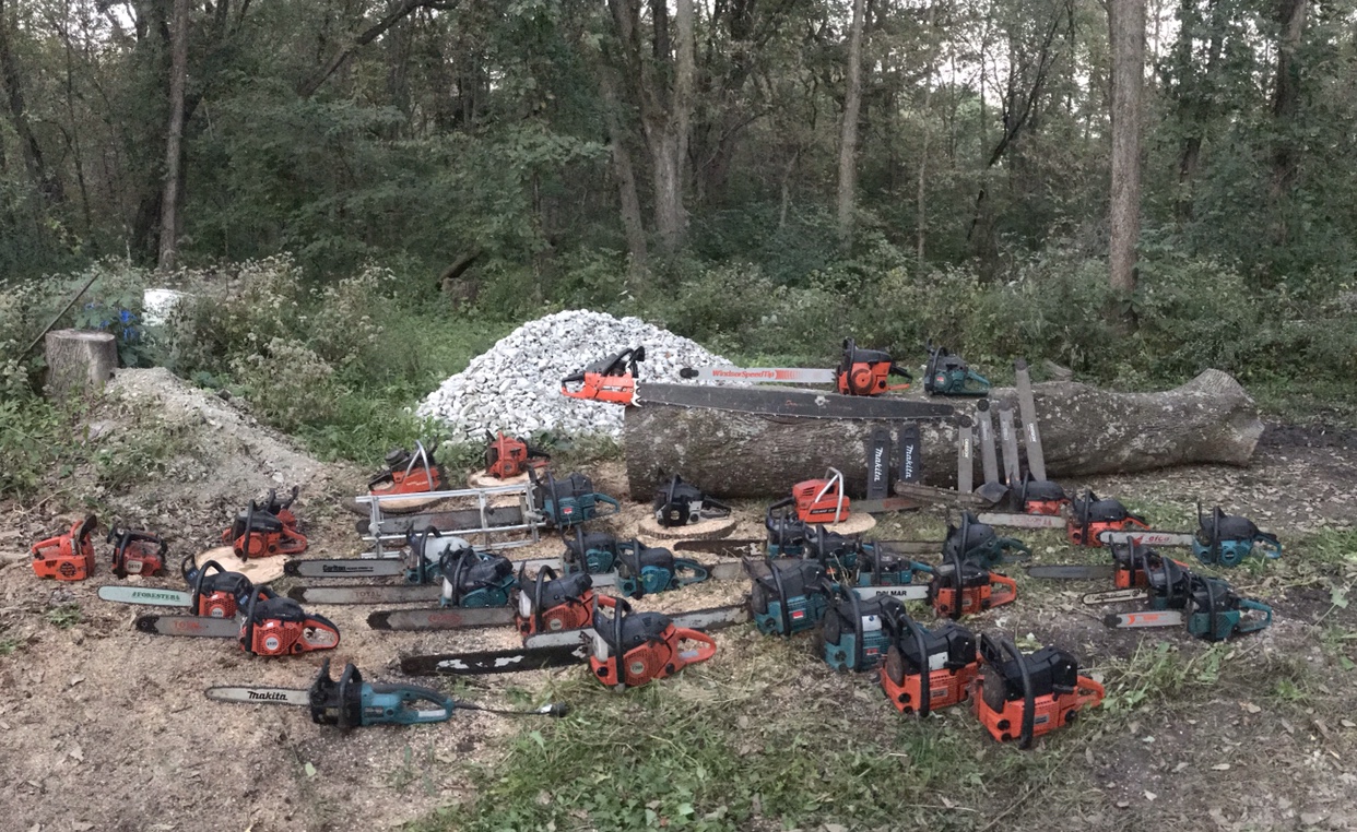

New dolmar/makita family photo. Please keep in mind all but 2 of these are runners with b&c’s and I get them out at least once a year to “blow the dust off and shake the cob webs loose!”
Who’s ready to play “eye spy?”

I spy a Sachs-Dolmar 103/105 to the far left and a Dolmar PS-3410 right next to her.
Several 9000/9010's, 79's and a whole bunch of other crap that I'll gladly all take off Your hands for a small fee . . . :rolleyes:
Make another family photo, that one is very low quality, very grainy. :confused:

You spent half a day just dragging saws out then another half day putting them away!:pesas: Very nice collection.
That is half the fun!!! :D
I have to make a couple new family photos with my current lineup, stack 'em all atop my firewood log pile. :)

Hi Nathan,
do you have such monster trees in Iowa requiring the extreme long bar on the 166?
How long ist btw? Makes the saw next to impossible to handle IMHO.
It’s 72” (183cm), and helper handle on the business end makes 50-64inch stumps easy to do in a single pass. I get called every so often to deal with stumps and bucking on 60-100 year old trees in town that are huge and belled out at the bottom. So yea that bar has been used 6x and paid for itself already.
