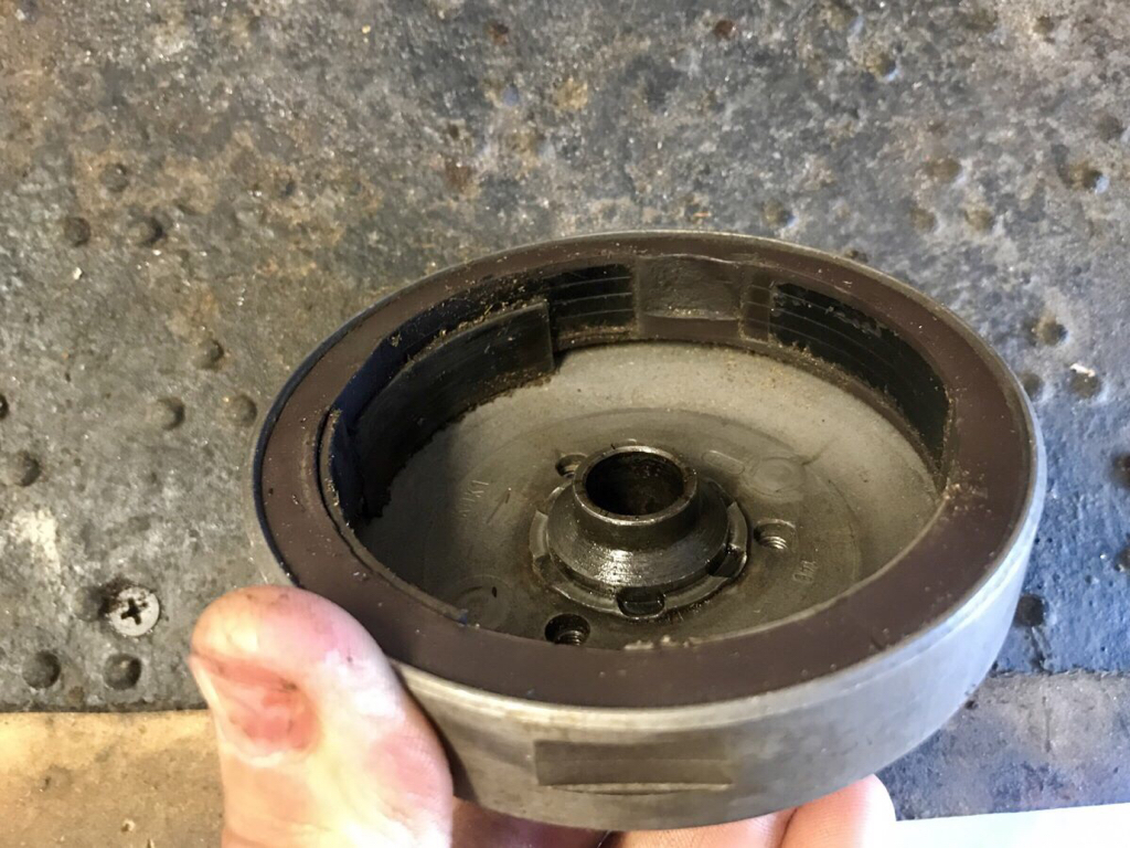

Its missing one of the magnets all together, unknown if its a N or S polarity that is missing. I’m not going to throw it away, that’s for sure.
Been thinking about possibility of being able to modify a newer model electronic ignition mounted under the flywheel and removing all but 1 of the magnets. I’m sure some crackpot inventor out there has done it

Prolly came off by crashing into the pole laminations on the coil frame. Loose main bearing or possibly tramp steel/iron picked up by the magnet(s).
how do you make a magnet with only one pole, either N or S? ;)
because i'm thinking that every magnet has two poles. :pesas:
In this case the effective pole is the inward face of the magnet, to reverse the polarity it would have to be flipped opposite of the radius that it's formed to.
As they usually tend to be brittle, that wouldn't work out well...
This explains it pretty well. If you have 2 magnets and place them on your bench, they will attract each other and “snap” together. Now if you flip one magnet over, they will push away from each other. Same idea inside the flywheel. 3 magnets are placed in such a way that they “attract” each other and the 4th one is “backwards”. The 3 magnets charge the system and the oddball magnet is the trigger.

Thinking a bit more about this...
Are those plates that came loose the magnets or are they just steel and the magnets are in that outside thicker band?
To be honest; I’m not sure. The outer band seems to be 1 piece, so if the band IS housing the magnets then my crackpot idea will be much more complicated.

So I just pried one of the other remaining plates off and they definitely are NOT magnetic. It appears as if the magnets are iside the outer ring. Its almost as if the entire outer ring is magnetic, which make no sense whatsoever.

91EFF8DF-C3D7-45EB-A992-60F6E554EB04.jpeg Poor old wood chisel.... Got used on metal.
The outer ring is 100% magnetic. There aren’t an actual magnets, it appears to be impregnated with any “magnetic material” in specific locations. I did chip off a piece and applied it to each of the steel insert locations and one of them is definitely opposite polarity.
