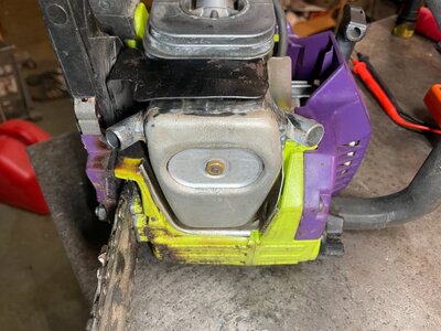

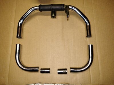

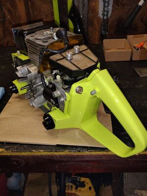

Got the new ring installed. Wasn't quite as easy as I imagined, obviously the ring won't fit in the cylinder to measure since it's oversized. So I took a few swipes at the ends and before I knew it I was at .009" gap, was aiming for .007" but good enough. Came out to a whopping 145psi lol.
Last week while waiting for parts and stuff I had nothing else to do and welded a dual port exhaust. This was minimal effort work but it looks aggressive and breathes much better now, probably the most effective mod I did to it and also the easiest.

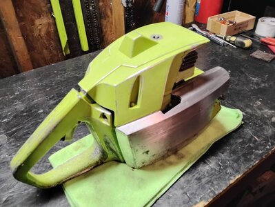

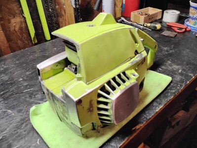

The case on this patched together machine is Poulan badged, does that count? This ugly old 455 with pioneer parts is today's favorite. I had to weld a few holes, including under that patch of primer on the gas tank. Those Boyesen reeds are a nice upgrade. Very improved idle and spool up.

Those saws are strong runners , 405 BP

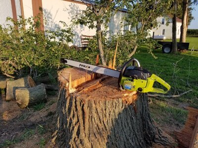

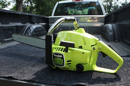

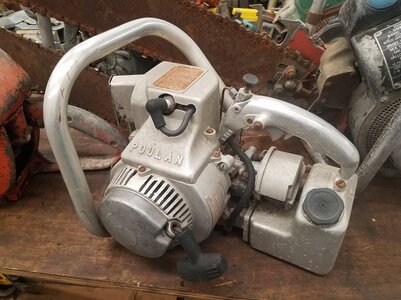

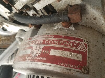

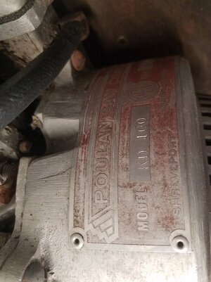

This came home with me from the PNW GTG last month, I guess it could go in either the Poulan or Pioneer thread.
Even with a compression release, you'd better be serious when you pull the starter rope...

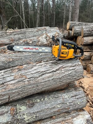

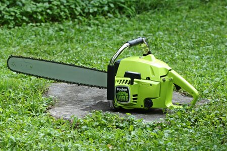

I’ve been clearing my way into an old honey hole that I left to grow over for a few years. I’ll end up with all the D.Fir I can burn next year before I even get to the good stuff. Had the 3000 and 4400 out. The large frame CounterVibes are very, very rare out here in BC. A few survived on Vancouver Island and I have only seen one for sale a bit closer in the Kootenays in 12 years of looking. I don’t run the 4400 very often, but it sure chucks the chips. Threw in a jug of vintage 40 year old heavy red bar oil from Canadian Tire. Bloody slaughter.
Nonetheless, looking for a tensioner pin assembly north of the 49th if anyone has a pile of old carcasses and a love for Canada Post. PO somehow butchered the original one and it worked its way out in the bush. I should have known better. I have one sourced from the States but shipping is off the charts atm. Tried my bin of random tensioner assembles without success. Could cobble something together.

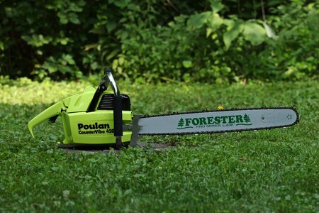

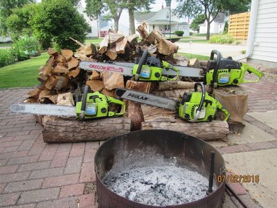

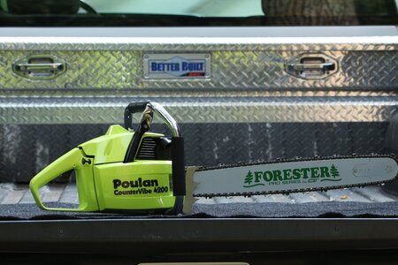

The CV models were very fine saws. I have a 5400 that I still use from time to time, and another in the display in my small chainsaw museum.
My 4200 (bottom, right) is battle tested but does have a NOS Poulan branded hardnose bar.
