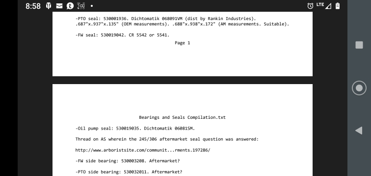

I need both crank seals for a Poulan 245a chainsaw.I have been look on line but I can not figure it all out.It is a cool saw. It has the bow chain guide on it. it runs but you can tell it is running LEAN. Thank you .
I hope this helps.

Can anyone tell me how to service the oil pump on a Poulan 245a.. I have installed a new PTO side crank seal. When I open up the oil pump it had a little grease in it. Do I put grease all over the inside or what . Thanks
Check page three for the oil pump clean and lube in the attached file.
These seal numbers come from a reliable source but I haven't had to try them yet.
Poulan 245/306
-PTO seal: 530001936. Dichtomatik 068091VM .687"x.937"x.135" (OEM measurements). .688"x.938"x.172" (AM measurements. Suitable).
-FW seal: 530019042. CR 5542 or 5541. Timken National 471315 .562 X .999 X .256
-Oil pump seal: 530019035. Dichtomatik 06081SM

Thanks fossil for the info. I was lucky enough to get it all back together on the first try. This saw had so much rot in the gas tank I had to replace. Lot of holes through it. This thing has the bow type bar on it. Some got rid of the points and installed a electronic ignition on it. After a carb rebuild seals and new tank this thing runs GREAT. Thanks again for the help.
