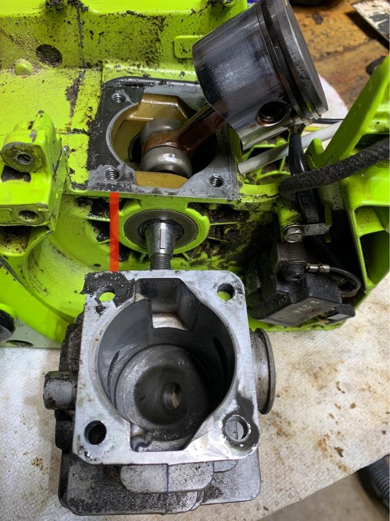

Fishnuts2
1:01 PM
284
1,096
6,516
SE MN
Found my first example of a “Half base gasket delete”! Ran great but wouldn’t idle right.
Poulan 3300
