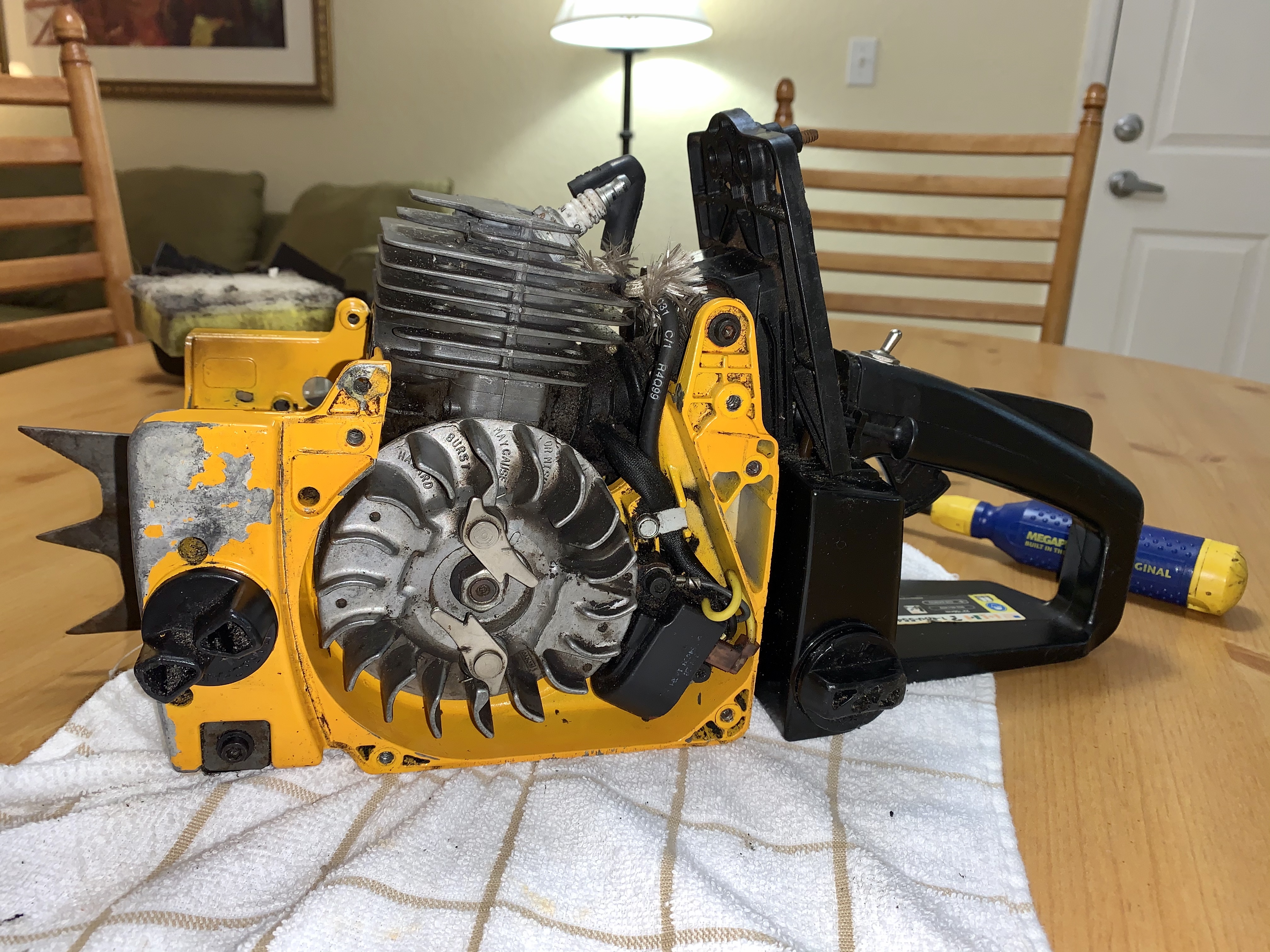

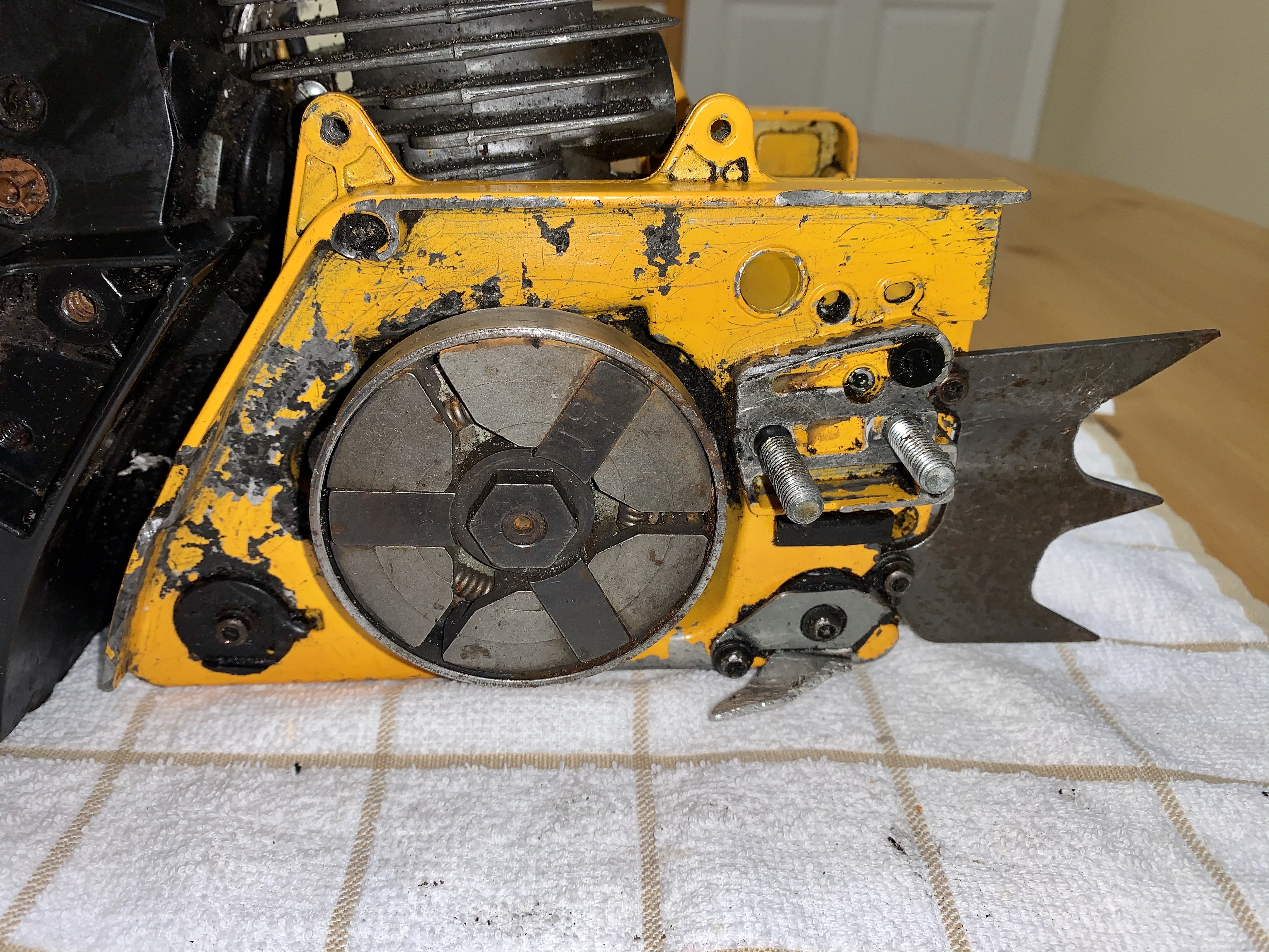

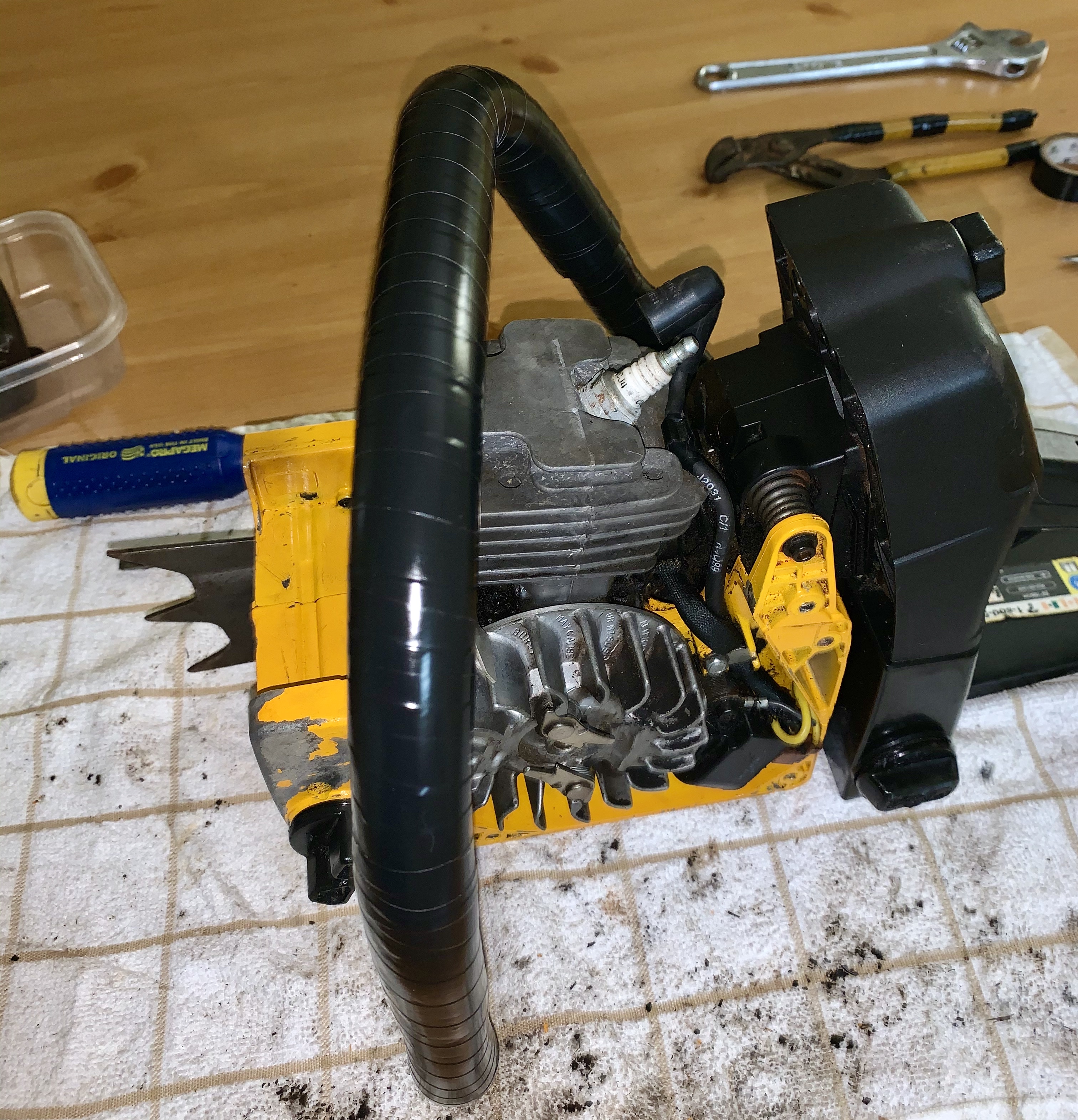

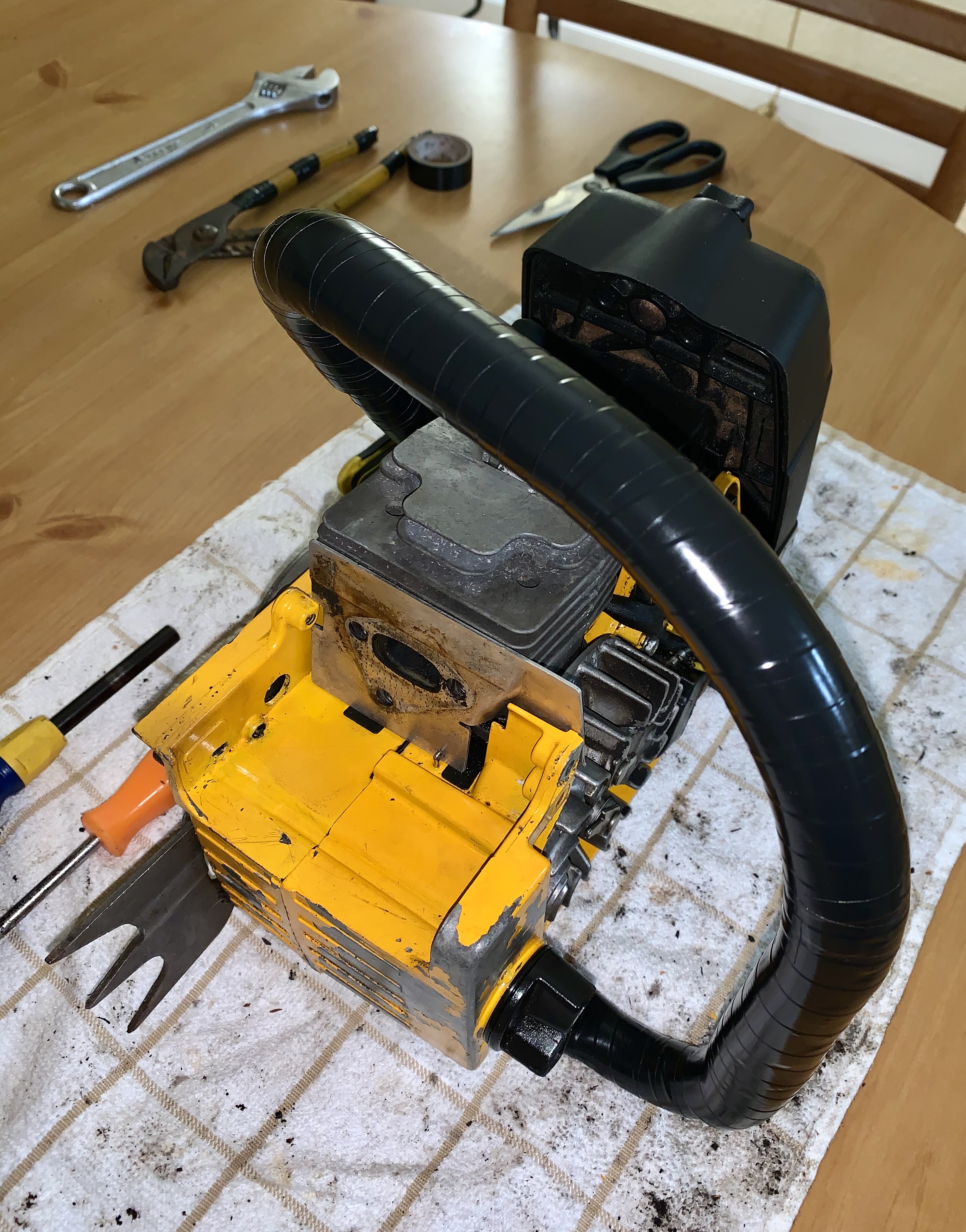

View attachment 206261 View attachment 206262 Wish my 3700 was that clean when I got it. Dime size oil hole strikes again.View attachment 206263 Not spotless but good enough for something I'm gona run regularly.
The amount of gunk was insane
Huh?? I don't seem to see any noticeable dirt on your pics. IMHO that saw looks pretty clean
