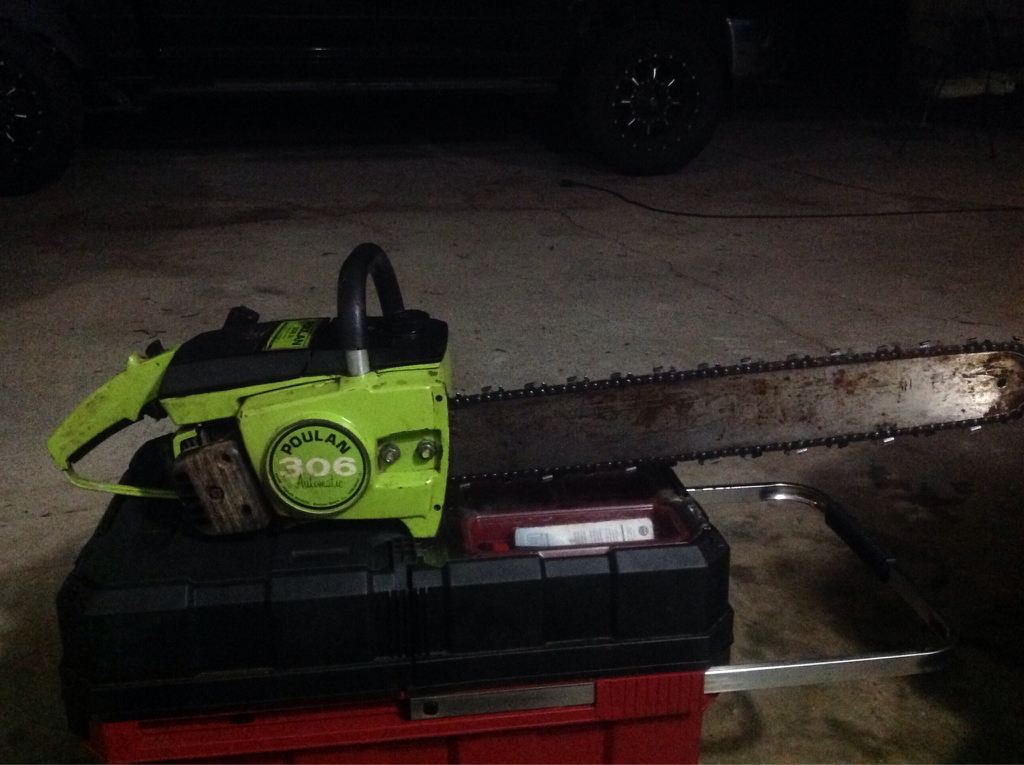

Little something I ran across a couple weeks ago. She runs very well. I like the way she pops when she's just idling.
mine. cheap, runs, too.
