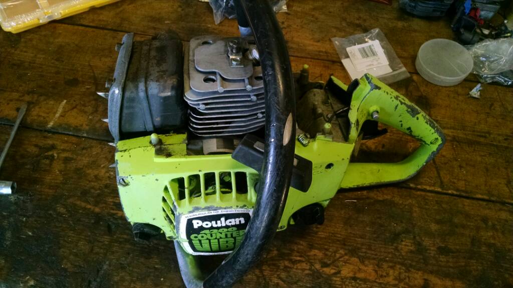

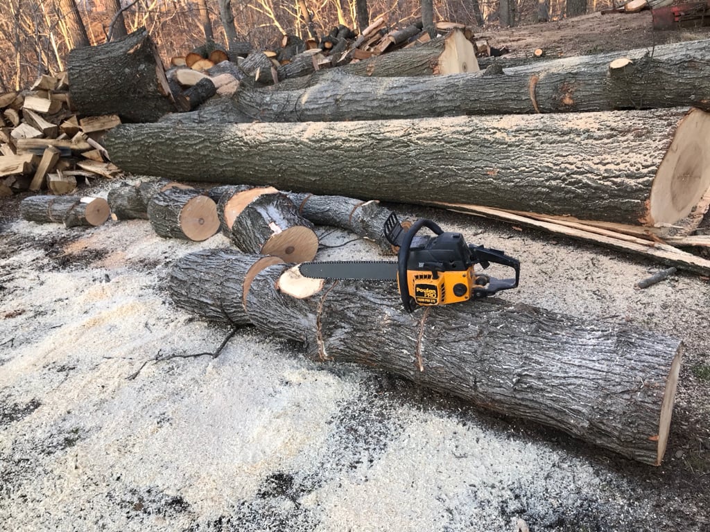

Just sold this 330 to a local guy and modded a k095 for him to run 20" 72dl chains. Sent me a pic of first use cutting some downed cherry.
Muffler baffle opened inside and dual port on side of front cover too.
