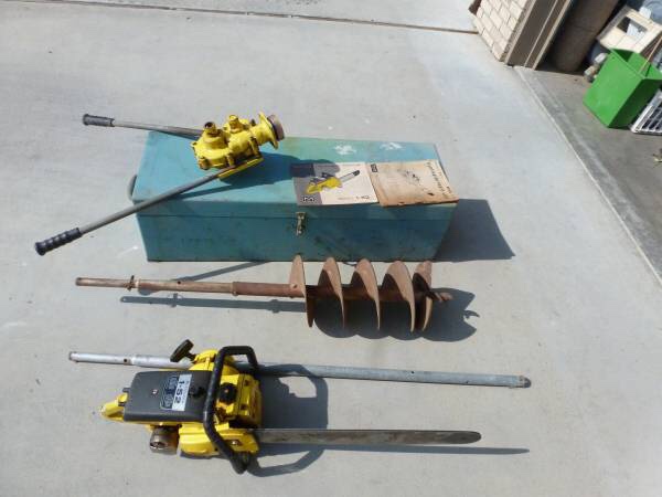

A 1-52 and Auger
Bakersfield, Ca
https://bakersfield.craigslist.org/tls/d/mcculloch-1-52-gas-chain-saw/6484582819.html
