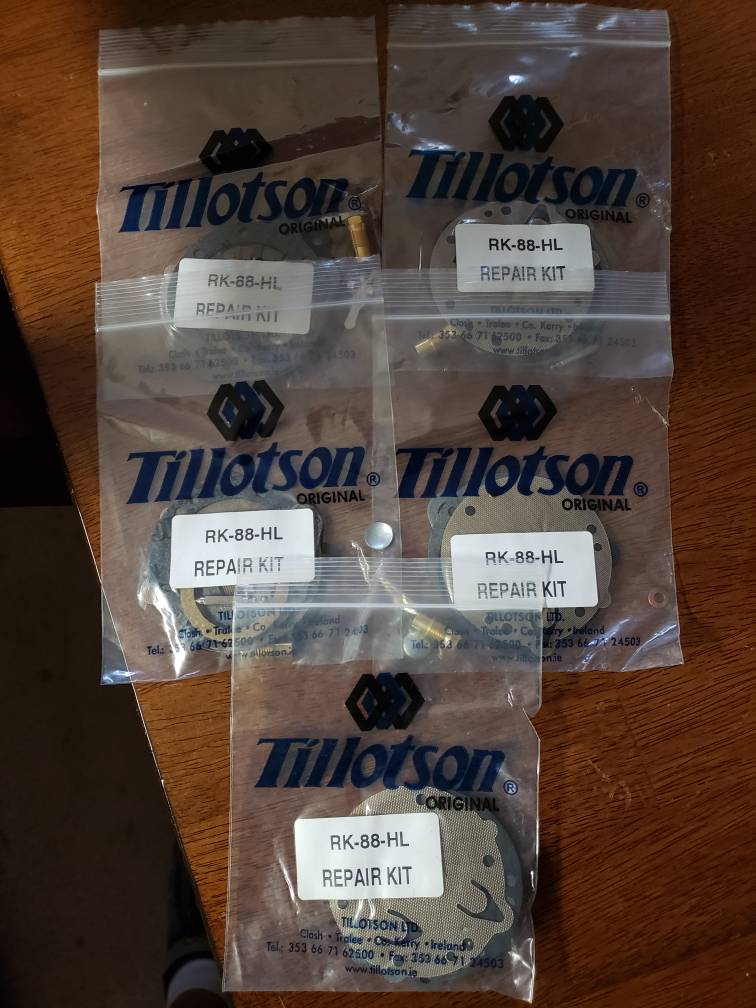

Tillotson RK88HL, make sure that you get the lever flush with the base of the carb, very picky.

Some good deals on Amazon today if you have Prime. Those kits (OEM) can be fairly pricey otherwise unless you shop around.

Not sure what the hell happened with the zzz's but if you put the # RK88HL in Amazon or Ebay you can find them easily. Yes OEM is a bit more but if you find them as I do in volume deals. Some of the aftermarket kits don't seem to work properly and all but the lever spring is in the OEM kit.
