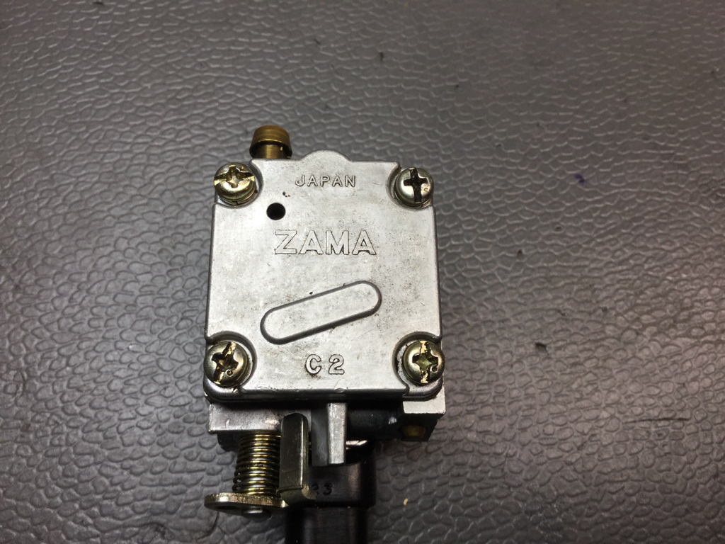

Fellas, I’m trying to put together a few bucket saws, a pioneer p60 and a promac 850
The 850 has a Zama c2
But I find myself wondering if anything would be better.
Looking for a screamer.
