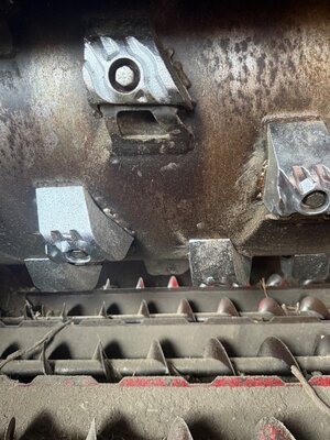

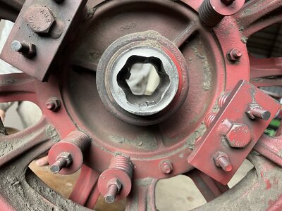

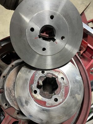

In other news I got up close and personal with some things on the combine we forgot to address this summer. The feeder stopped working and upon inspection I had a moment of “well crap, I knew I forgot to fix something this summer before we needed it!!”
Old hub vs new hub. Good grief I can’t believe I let that slide by the summer inspection 🤦🏼‍♂️

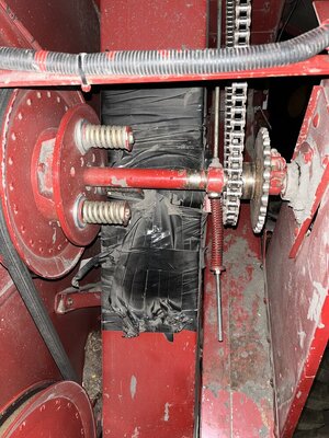

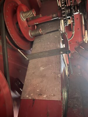

Dang it !! The clean grain elevator hath sprung a leak. Looks like a previous owner made a halfarsed repair already.
A roll of tile tape made for a decent infield patch that lasted the day.
There is nothing as permanent as a temporary fix …… naw, this needs a proper repair in a few days when we finish corn. Combines gonna get shoved in the shop and lots of stuff is going to come apart.
Munching up stalks for bedding. Gonna bale around 400 acres this year if Mother Nature cooperates. A few neighbors want some as they’re gonna be short so I told them if they chop and rake what they want plus an equal amount of acres chopped and raked for the stuff I’m going to keep I’d bale them for the net wrap and diesel cost to run the baler. Not sure if it’s a fair trade but chopping stalks takes time away from other things I need to do so it saves me time.
I’ve got a bent clean grain auger underneath the green one. Not too sure how one of those bends. Flighting looks like new

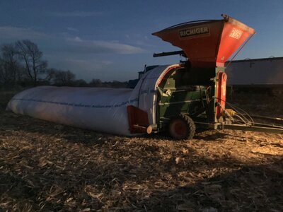

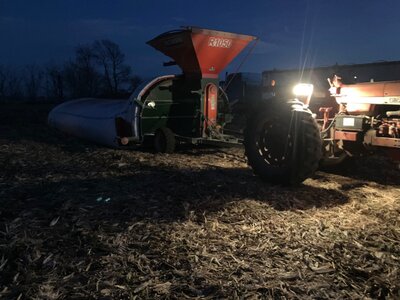

Any of you folks have any experience with bagging corn ?
We started last night, looks like it has the potential to be more of a monumental PIA than anything.
If it turns off wet, getting it out isn’t going to happen with out a lot of issues.
Wildlife damage to the bags seems to be a big problem as well.
