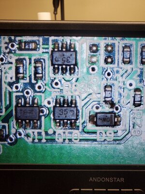

Naturally, I cracked it open like a crab at a seafood boil. Turns out, it's full of tiny little voltage regulators stepping 12V down to 5V and 3.3V—like a Russian nesting doll of disappointment. There’s a microcontroller that should drive 3.3V to a mystery component (my money’s on a transistor), which then activates the coil + and pre-charge signals. Spoiler: mine did not.
I even desoldered this “mystery meat” component, hoping to unlock the secrets of the universe. But no dice. Still no 3.3V. Yet the display works, error codes flow like wine, and other signals are acting normally. So the micro isn’t dead... just moody.

The Deepest Dive Yet: Opening the Motor Controller
With the harness in pieces, VCM cracked open, and my pride bruised, I decided to operate.
I opened the right blade motor controller like it was Thanksgiving dinner. A few capacitors came off to expose the internals. Sure enough, a power trace was glowing under load like a toaster coil. Let’s call it what it was: a hot, smoldering short.
Pro tip: If you don’t have a thermal camera, you can also give the circuit 3 amps and wait for smoke signals.
Disclaimer: That’s a joke. Please don’t actually do this unless you enjoy turning your components into charcoal briskets. You’ll probably just cook something else in the process—ask me how I know.
Once I dug out the carbonized debris (which I assume used to be something important), I applied solder mask to rebuild the trace’s integrity and reinstalled the capacitors I had removed during the diagnosis. Then came the VCM reassembly—specifically reinstalling the mystery meat transistor, about 2mm x 2mm (roughly five cow hairs in width, for us metric-averse folks).
To my surprise, it still worked.

Inside the motor controller, I also found an interesting sidecar PCB encased in what looked like a copper Faraday cage, soldered directly into the main board. Naturally, I desoldered it.
It turned out to be a simple daughterboard with a few CAN-related ICs and passives—likely to translate CAN to something the main controller microcontroller understands.
My theory: This tiny board is what differentiates a left motor controller from a right one. That means, in theory, if you’re savvy with a soldering iron, you could grab any used LT42e or ZT1-42e motor controller, swap in your original CAN board, and poof—it becomes the correct one.
I’ve got a candidate controller on the way (from the ZT1, possibly for the left side), and yes, I’m going to crack my mower open again to test this theory.

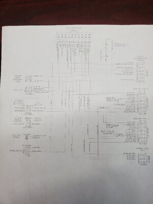

Bonus Bonus: Full Wiring Diagram
Attached below is the full LT42e wiring diagram, featuring a single-VCM setup (with either the “leaf” or “!” icon button pad). Hopefully, this helps future troubleshooters skip past some of the pain.

So… turns out the wiring diagram I mentioned? Yeah, it’s basically useless. Way too blurry to be helpful. My scanner decided to join the LT42e in rebellion and refused to cooperate.
I’m working on getting a proper scan uploaded soon—one that doesn’t look like it was faxed from the moon. Sit tight if you were hoping to trace wires without a magnifying glass and divine intervention. It’s coming!

Here is the scanned version of the wiring diagram. Should be more clear, it was a scan of a printed copy.

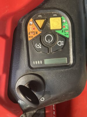

Wish you could stop by my garage and fix my Craftsman E150 Riding Mower! Although the Samsung battery reads 54 volts, the mower does nothing when clicked to "ON". Charger flashes a code for "Bad Battery", so no charging. Li-Ion battery may have an issue (unbalanced cell?), but the mower itself may be the gremlin. Why no convenient OBD2 port on mowers so I could scan it to find the problem?
Anyway, thanks for the fun read of your adventure!
Jwax,
Appreciate the feedback, it was an adventure! The battery system is the one thing I have yet to dive face first into on this system. First thing, did you check the battery inline fuse? Second, what is the code on the VCM? Third and final, do you have a two connector VCM (smaller display, 4 leds to the right of the display, big yellow square in the bottom left) or a single connector VCM (larger display with either a leaf or triangle with a '!' In the top right of the tpuch pad) that should tell us what main harness you are dealing with.

There are two connectors on the back of this panel.

Ah, yes. I think this is the first version of this system. Not sure if craftsman ever updated it like Cub Cadet did, I would assume so as MTD just made them all. Anyway, do you have the wiring diagram for this main harness? If not, I can dig it up.

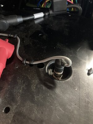

Thank you odonnse! Very helpful! Thought I found the culprit while digging in deeper- a very loose, large black cable loose under the locking nut.
Tightened, but still no go.
