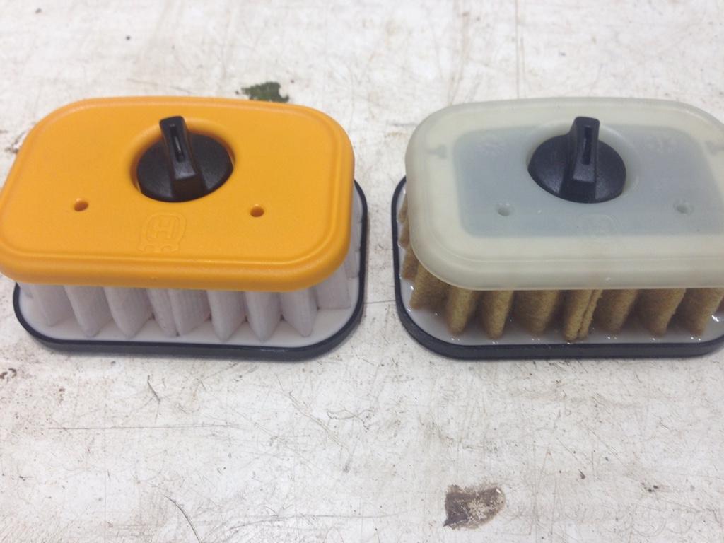

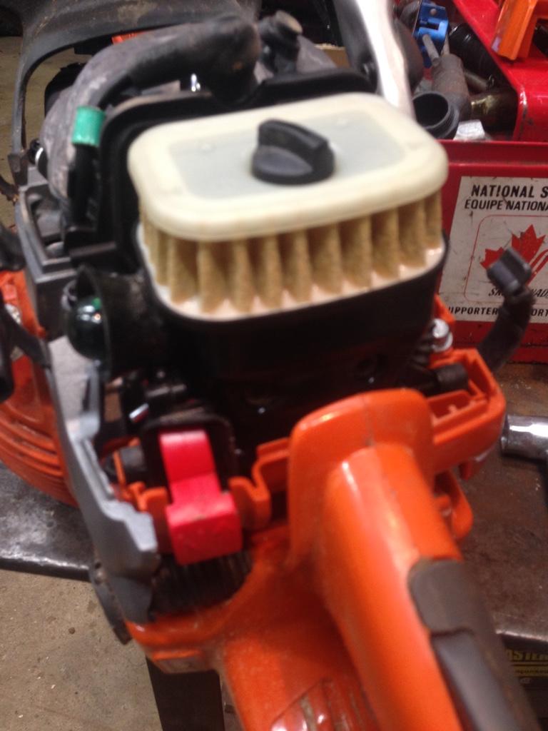

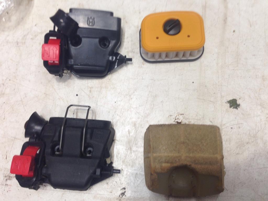

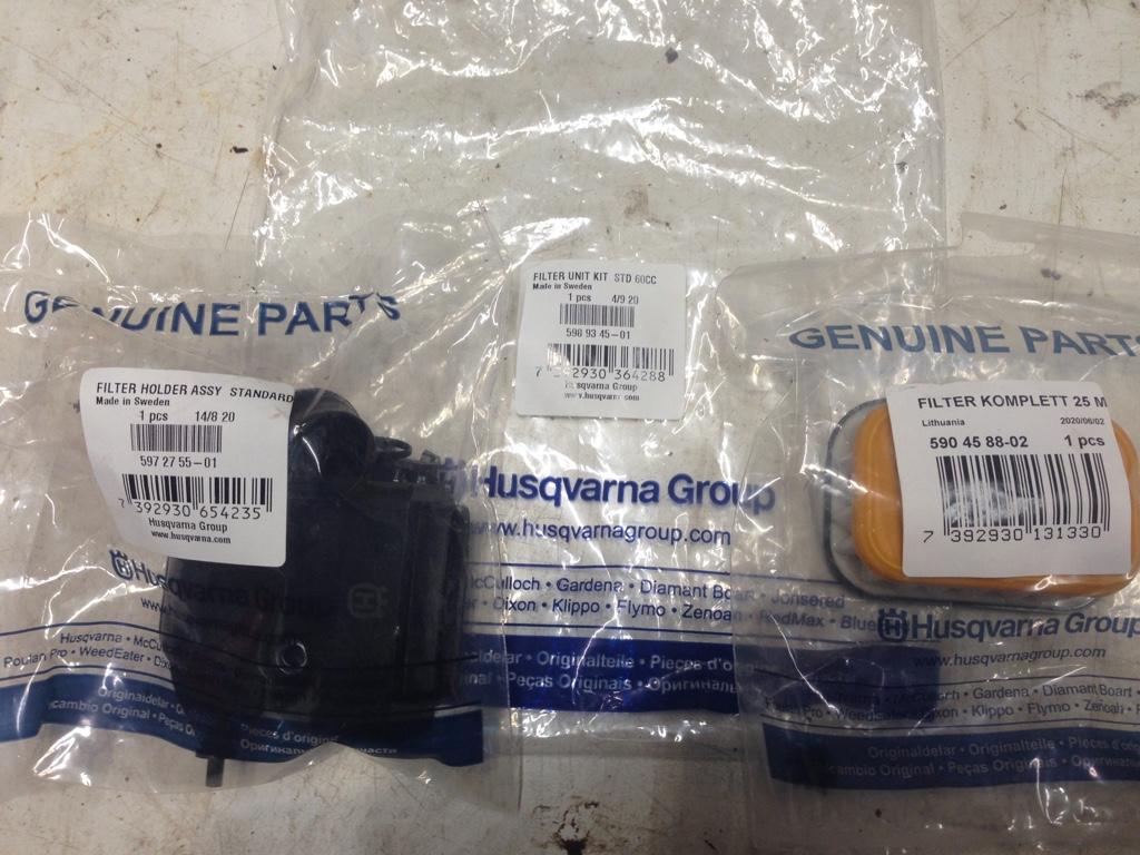

60cc filter upgrade kit bought for my old 562.
598 93 45 01
Includes new filter 590 45 88 02 and new mount 597 27 55 01
New and old
Interestingly my new saw came with a different version of the new filter.
Much larger sealing area to prevent fines getting by

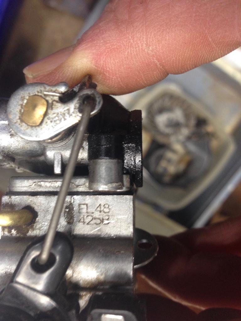

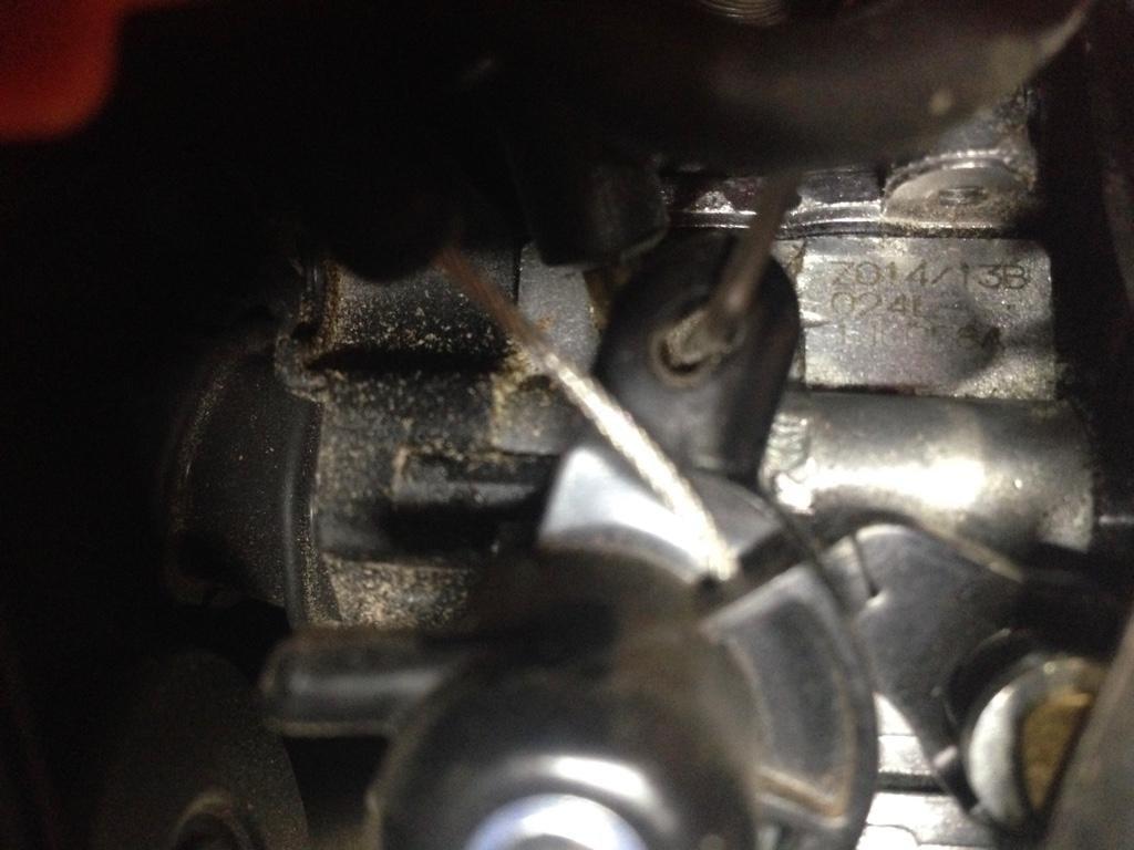

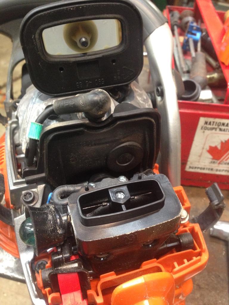

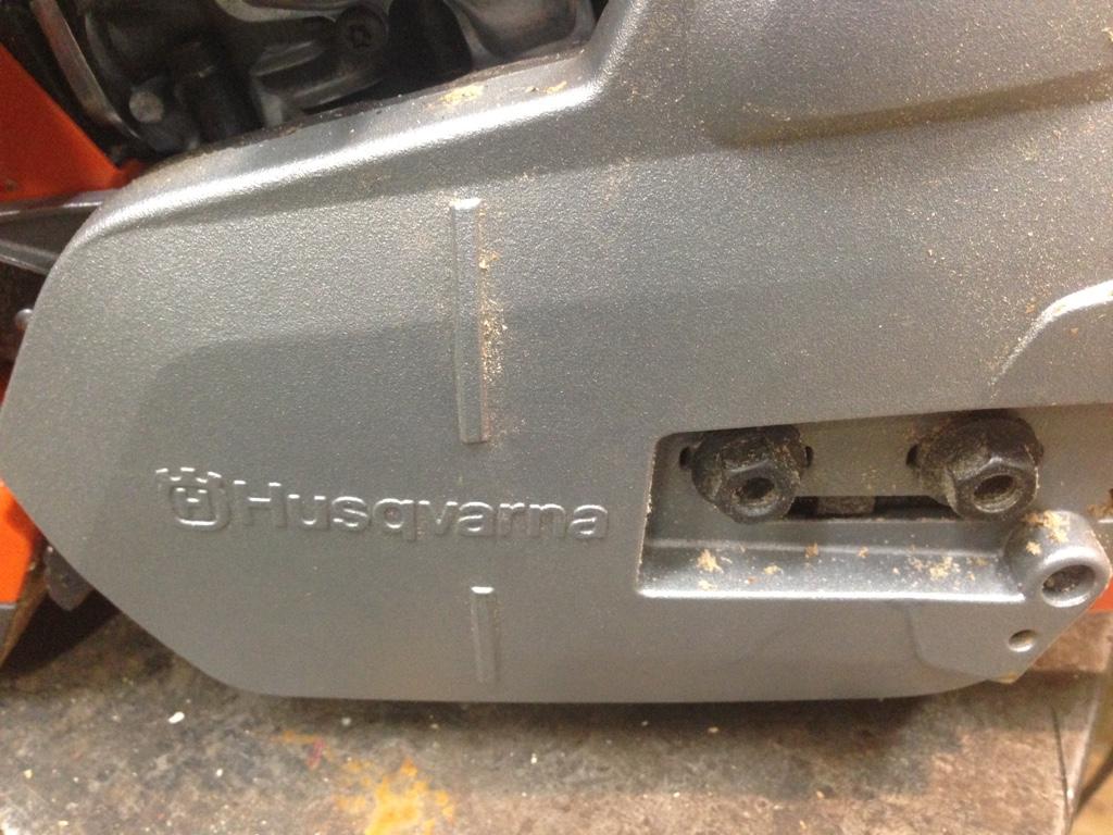

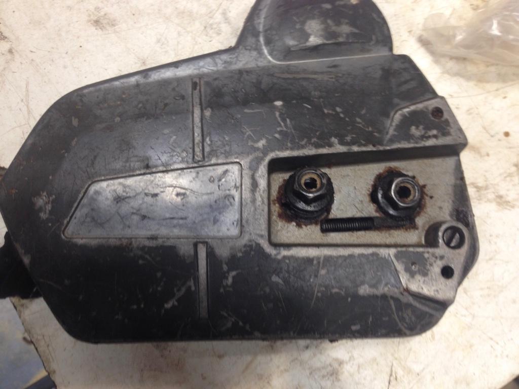

Other visual differences between the updated saw and my 2014
2014 Carb n EL48
New carb
Clutch cover
And the filter of course
Only have 2 tanks through the new saw so far. Seems a little cold blooded and wants fast idle to start even when warm, but then again it was cold and icy out. No problem at all with the 18” bar buried into 24” sugar maple.

How long to change it out?
