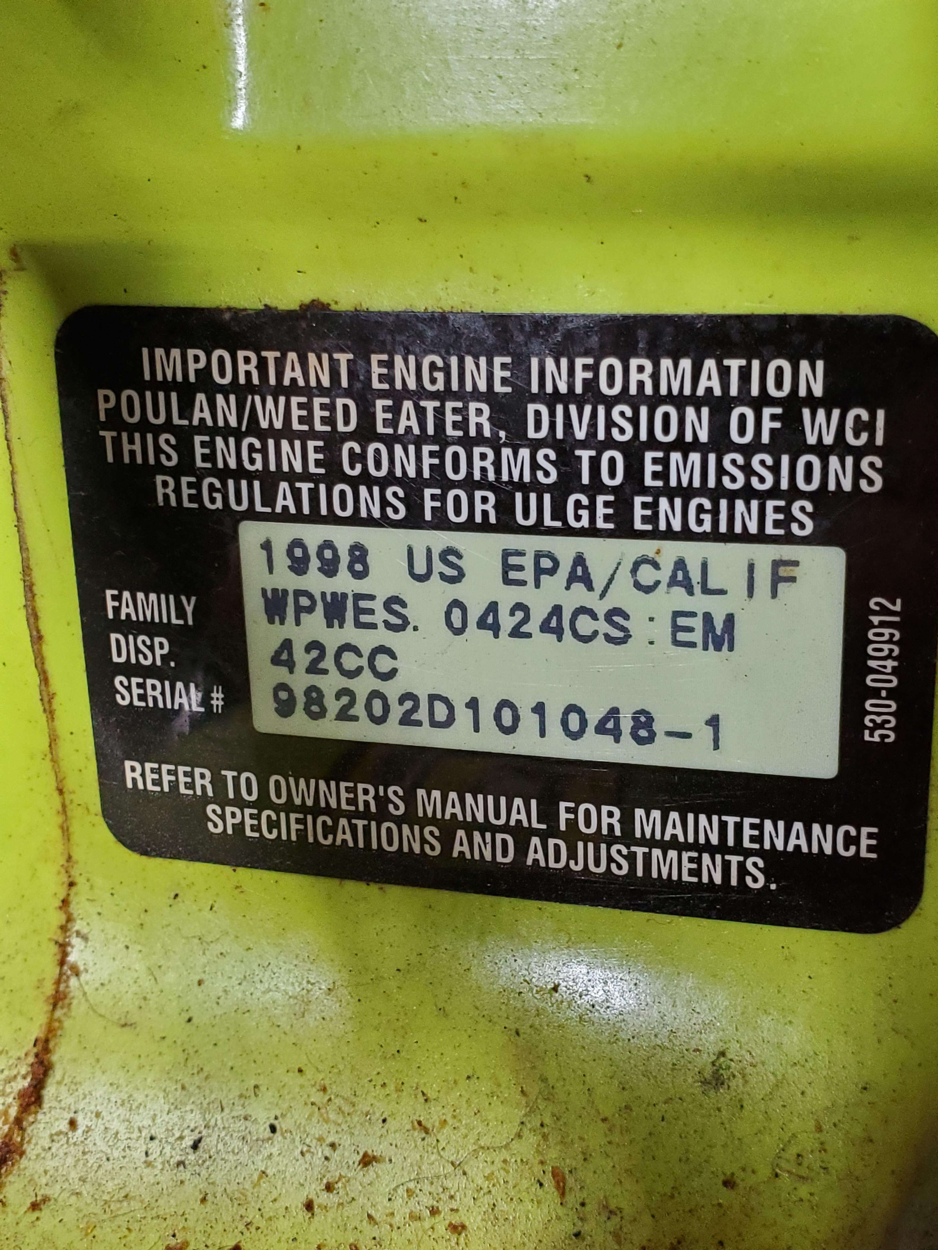

Question for you guys, Are all wild things 42cc's, and are they all clam shell design. I seen different
color schemes on them, Green purple, black purple, etc.
I think all the older ones were not sure but I’m thinking that newer stratto version is 40cc

I actually saw one for sale locally and rewind says 40cc but engine tag said 42cc
My 2375...I read they are 40cc but the tag shows 42cc.

I thought the 2375 or 2175 meant 2.1cuin or 2.3cuin, but they say 36cc or 40cc on the back.
