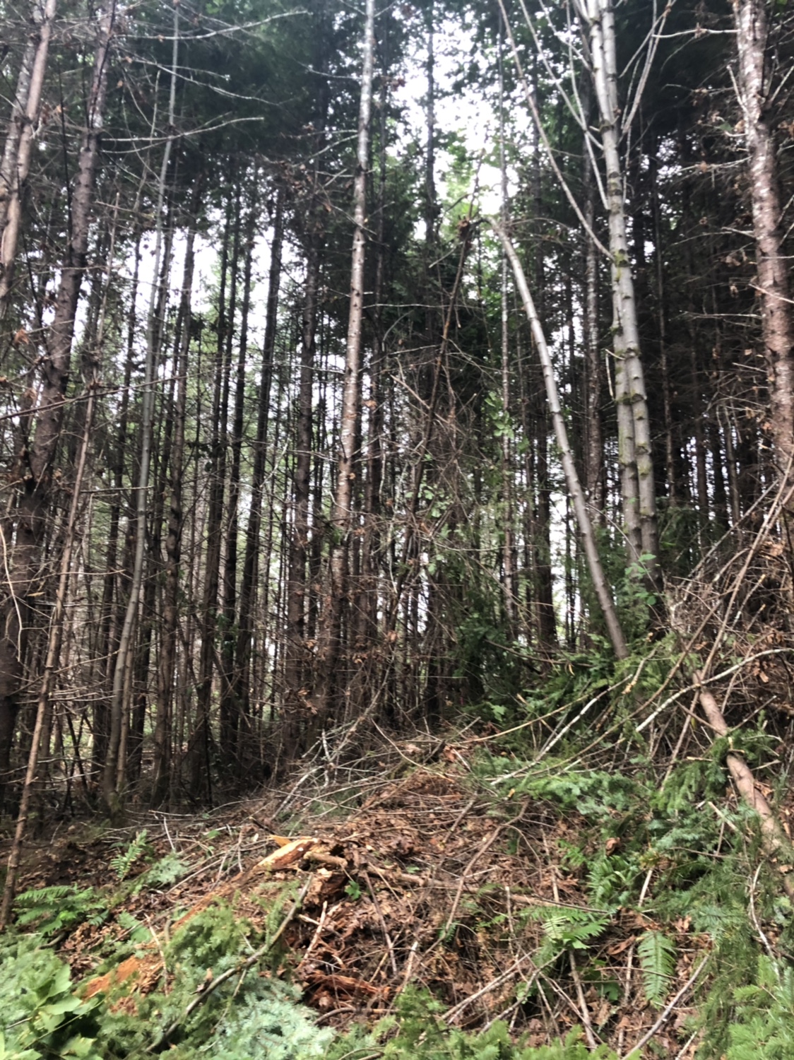

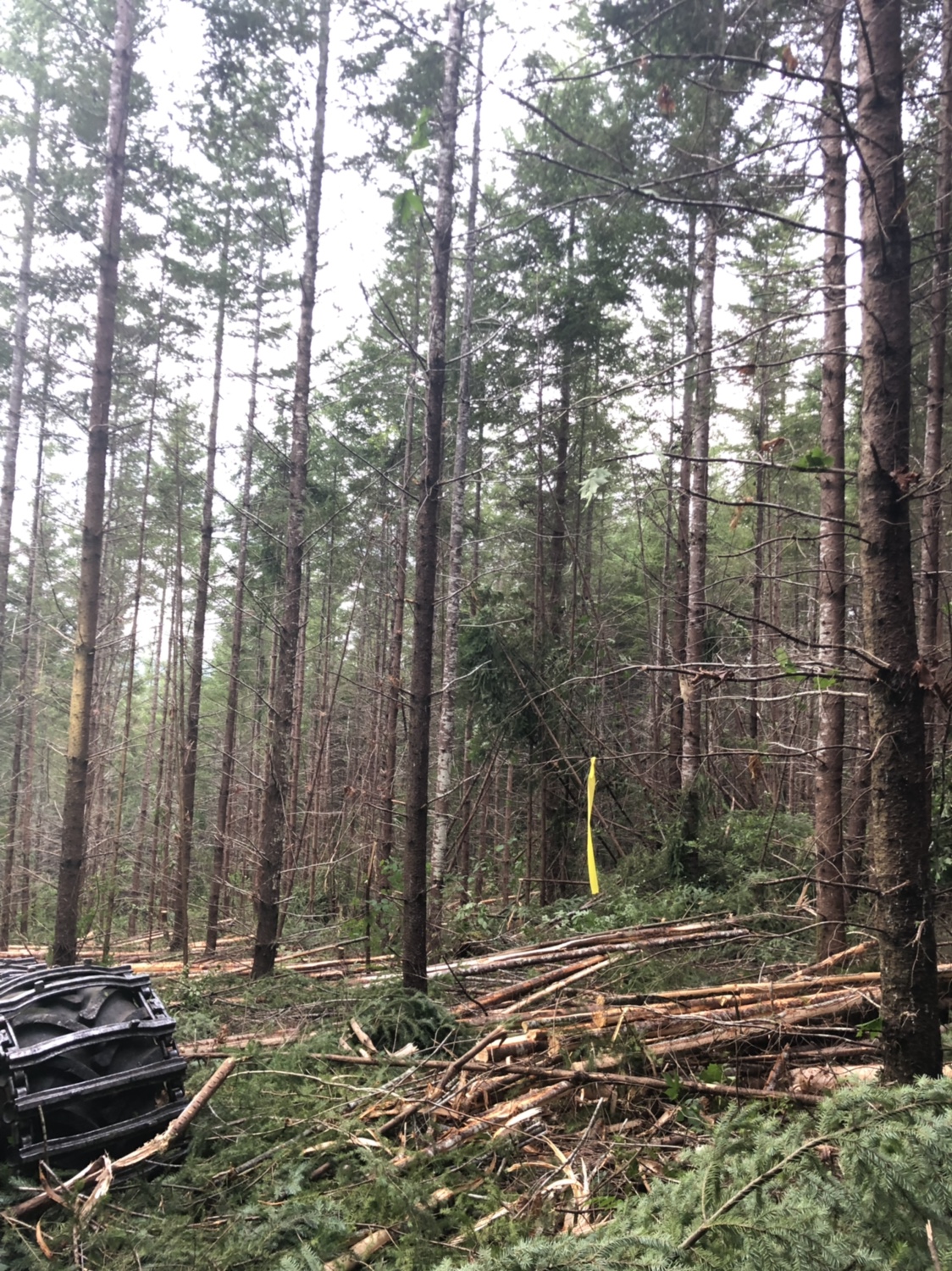

Before
After
Who's property is that ?
Looks like a heavy thinning

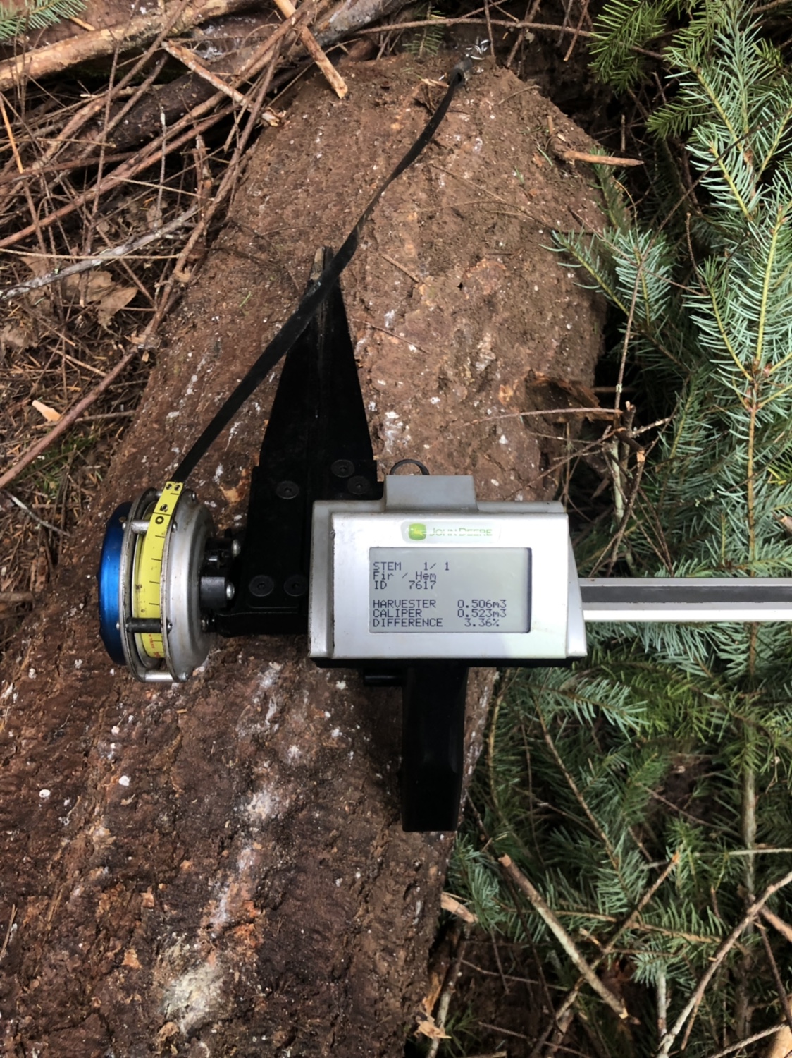

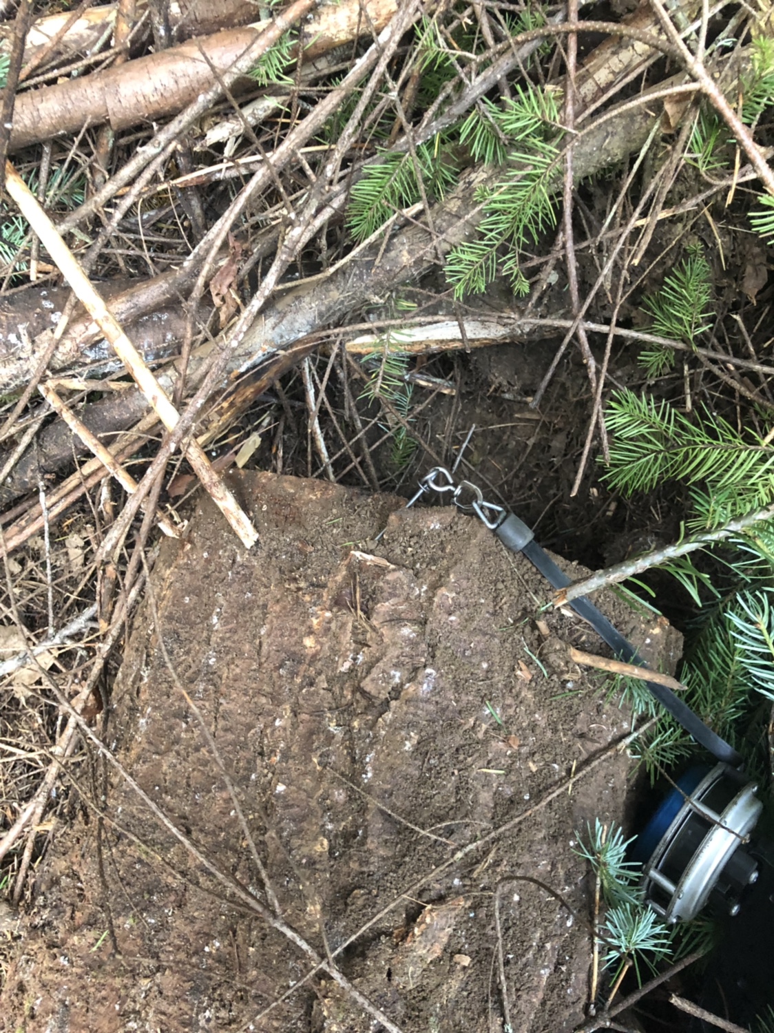

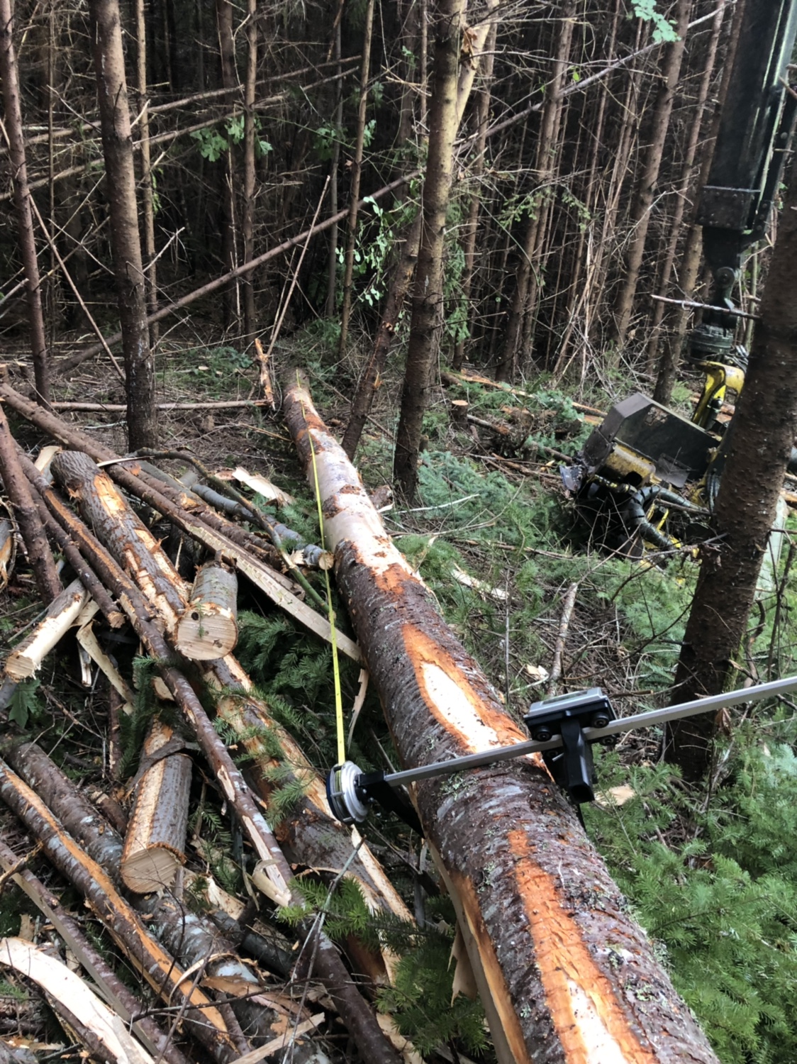

Yeah you're definitely walking back to the end to take that off. What's that caliper set up all about?
It adjusts the length and diameter on the head. In Europe the machine scales the wood before the mill ever sees it so at the end of the shift they have to send a report to the mill of what’s been cut with the scale report. They have a requirement of 3% of max variation between the caliper and the harvester. When measuring I enter the length then measure the top in two places then it has me go and measure on the 50’s in centimeters like 950, 850, 750, ect down to 150 with a last measurement of 130cm with all of these places measuring the diameter in two places.
