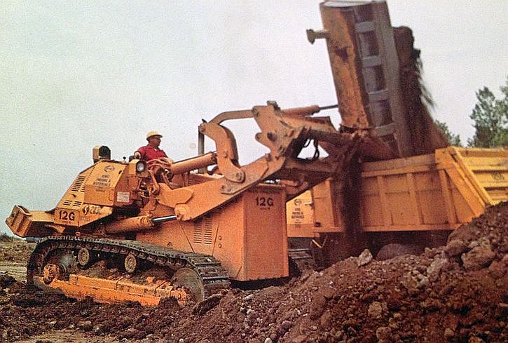

Whilst reading about the history of this mountain I came across that the road was cut and log skidded with an allis chalmers skidder, and while googling AC I found this. Seems like a function that should come back.

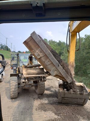

Being in the construction field and equipment operator i can confirm this function is still in use today...our wheel loaders all have this style bucket .
It's very handy in tight quarters and backfilling trenches .
On track loaders that function has mostly been killed off by the use of excavators when it comes to loading trucks. Or really, the modern hydraulic excavator has killed off the track loader for most things on construction sites that are any larger than residential sites. Most of the time they’re used on utility or site development projects for backfill, toting pipe/drainage structures in poor underfoot conditions. They’re still a handy machine, but with the rise of reasonably sized and capable hydraulic excavators over the last 35-40 years the crawler loader has lost a lot of its popularity despite it being super handy tool.
On wheel loaders those side dump buckets are still very prevalent for doing things like toting rock for pipe bedding & padding or filling bedding boxes in tight quarters where the loader can’t turn to square up to the place it needs to dump.

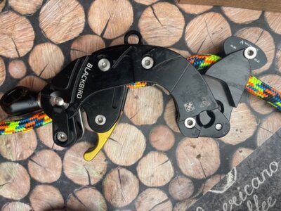

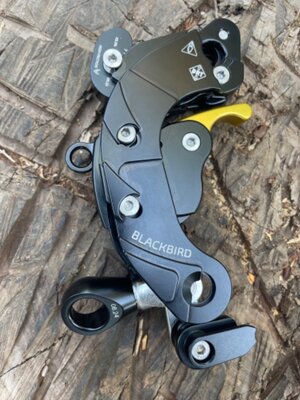

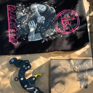

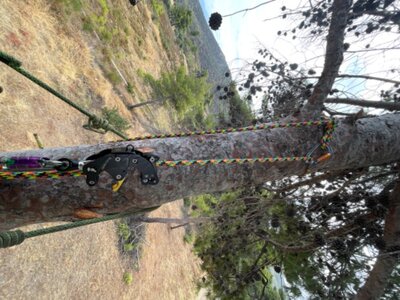

618D9660-6E3E-430D-9250-F41B76CF0F1B.jpegIMG_6110.jpegArt Blackbird

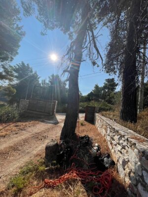

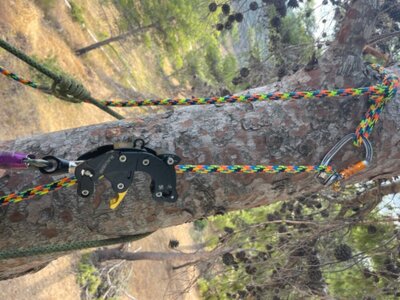

While most of the planet still on "pre-order" list i got it yesterday in my hands, one of the very first people
Well the ordinary people and not the "show queens" that get them for test for a few days and then return them.
Now let's see if this device which supposedly is revolutionary is ok for Real Work in my conditions

Let us know how you like it. My Akimbo is on it’s last settings with a 13mm rope. I’ll be in the market soon.

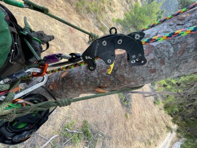

And i was about that

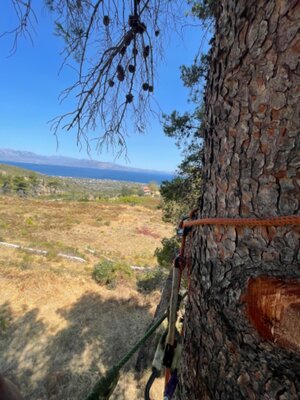

Today first TEST FLIGHT
Starting combined 2 ropes one with Distel and attached at the other side the Blackbird to see the initial movement in SRT of course
I was like that the pine was Double and after that used it alone in the next pines
Friendly house had to clear the pines so no rush no real client and today did a total of 6
Used a "like new Xstatic which for me is the best rope
Here we go
-Midline attachment- not easy takes time, stiff and at least 3 moving parts inside to put the rope. Slow in the ground even slower up in the tree. It's not only the "push pin" to open.
- has 2 settings low/heavy friction up to 12mm and then another head for bigger ropes that you have to screw and interchange.
I used the low/heavy friction and i believe the low friction is the best
It moves smoothly BUT suddenly feels like a handbrake and then again it releases really instantly that aint good
For sure it's milking ropes more than any device i had like Blue original Akimbo, ZZ+ or RRP
MENTION that pines in my country are different full or resins and ropes/mechanisms shut off
Working here feels like Medieval torture no space for throwlines etc for the most part at Pines.
Worked most ascenders missing only some American stuff like bones or Rock Exotica other than Akimbo due to CE
And i finish my first review as
Blackbird needs transition time -training to get used I personally cannot trust it within a day like i did with ZZ or RRP
For me personally and the situations i have to handle there is only one God and that is prusik knot. I believe any arborist can solve any problem with a knot and a Isc squirrel it's the only way i feel confident to work in the worst environment

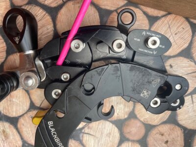

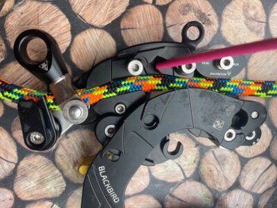

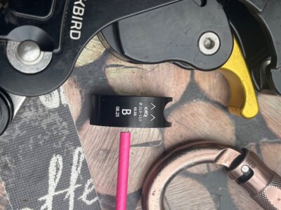

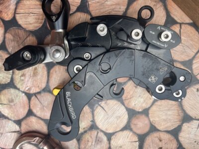

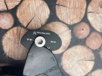

IMG_6160.jpegIMG_6161.jpegIMG_6162.jpegIMG_6163.jpegIMG_6164.jpegLet us know how you like it. My Akimbo is on it’s last settings with a 13mm rope. I’ll be in the market soon.

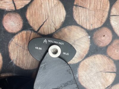

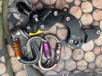

Let's get a more detailed function review
Don't mess with me with Grammar if it is a head or cam or piston, i ll describe it cause English not my native
Lets start
You see there are 2 heads
One factory installed up to 11.9mm and another in the box up to 13mm
You can see the heads are inside from the trigger release
And there is also low/high friction choice everytime available. I tested it and yes it works you can feel and see results

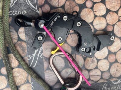

FOLLOW THE STRAW TO UNDERSTAND FUNCTIONALITY
There is a spring pin down once you press the smaller part comes down and circle backwards and then press again to send the whole mechanism forward. That looks easy?
Then you have to set the rope inside and Odyssey begins
The lower part is pretty stiff and you have to align with the mid part, there it's gets nasty you have to use your finger to press the cam (which ouyside has the ring for srt) so rope can sit.
In reality it's a Swiss precision watch mechanism that training needed to have everything aligned
Now during work in a hurry, dirty sticky gloves like mine with resin and alot of other difficulties not sure.
I believe though that at the very end once Blackbird gets a few work cycles and moves become routine it will be the mechanism to
Conquer the planet
Akimbo 2.0 is nothing other than choosing the can for ropes so there is NOTHING revolutionary there
If i was in your position I would buy Blackbird cause there is nothing else out to justify

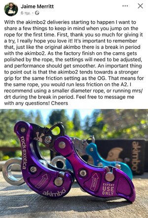

That's from the inventor/designer of Akimbo giving designs to Rock Exotica
All in all, the facelifted designs become more nimble, more rope oriented, heads cams etc more adjustable and i believe that they can't handle worse conditions
Therefore i went to Art Blackbird and seems the market will go towards that mechanism

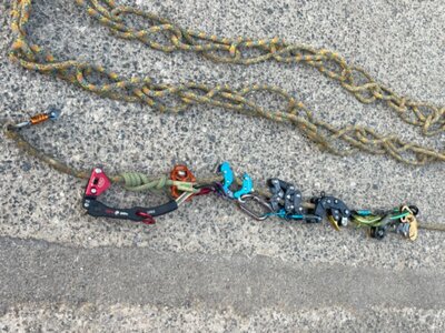

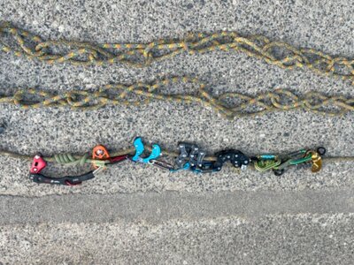

IMG_6190.jpegIMG_6189.jpegLet's pretend we follow the British homosafe standards so i made a safe and long descend
Seriously speaking those people from IRATA (who clean windows" even if in their Code 1.1 write they got nothing with arboriculture now they are pressing for 2 lines in the same tree and they try to manifest alot of ...you name it
Totally lost between shock absorber-fall arrestors and the real arborist work.
They were already ridiculous enough using the smallest bars available in any saw category like 45cm or 18" in 90cc now they doing their thing again in the European market
If you're serious about the work one wonders if they really climbed a tree or they made tree removal
Maybe they believe that their second line can hang from Big Ben
So let them have my Safety mechanic ascenders/descenders
