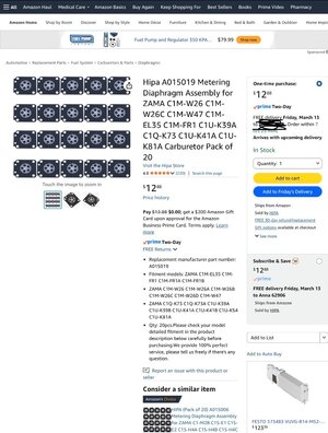

If the check valves in the primer base are working properly, a new primer bulb won’t make a difference. If they are leaking, then it might help. I would guess it’s also got a stiff metering diaphragm, which would be easy enough for you to change while replacing the bulb (it’s right underneath the black primer base). Of course you won’t need this many, but this is what you need.
It is an Echo engine, so any Echo dealer should have parts.

Thank you for the input - the weird thing is that it was working just fine before the fuel refill. Think the bulb wasn't even cracked, but I squeezed it a bit harder priming it, and it must've cracked then, because there was no leaking before, and now it drips as it runs. So, I don't know why the diaphragm would suddenly go stiff, but it's good that it's easily replaceable, only for the price of the pack I could get a complete carb replacement with lines...
