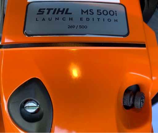

couldnt help myself.. was sold once i saw the special plaque on it. :) No more in the country till January’s shipment. [emoji12]
