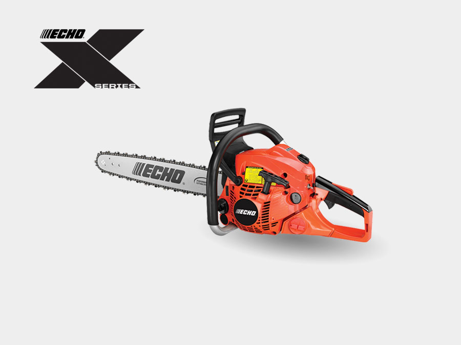

My next chainsaw that will join my MS-180 and MS-362CM. Looking for something a little more portable (read: easier to lift and use) but a bit more power than the -180.
Pro saw only. Small difference between the Stihl and Echo of .2 lbs on the PHO (10.8 vs. 10.6). Big difference in the warranty: 1 year for the Stihl; 5 years for the Echo.
Which one would you pick?

Bought a 501 last fall. Pretty happy with it after unplugging the muffler. Air filtration could be a little better. Nice power for 50cc if you ain't into cookies.
I don't know what this means?
A local Echo dealer is having a One Day Sales Event tomorrow; 15% off the Echo CS-501P. I think I'm gonna pull the trigger on it.
Simply put as long as you don't care about cutting speed.
If wanting something marginally more powerful than the 180 get the 501.
If wanting something in between the 180 and the 362 power wise get the 261.
The 501 is a nice little saw but compares closer to the 180 and does not even come close to being a 261. IMHO
501 makes for a lightweight homeowners saw for cutting limbs around the yard.
261 makes for a lightweight firewood saw.
Have owned or used 355, 501, 170, 180, 250, 261, which fall within the realm of your question my main saws are 70cc either Stihl or Husky.
End use and expectations need to be considered as well. IMHO

Apples to oranges. The 261 is the better all around saw. 261 also strato design, so burns less fuel.
261 available in autotune which is actually great. I used to be against it, but now I wish all of my saws had it.
Forget about the warranty. Echo isn’t known to be good about it, do some web research. It seems that they find a way to blame the consumer and not make good on things. Your dealer might be good enough to change that.
I’ve been deep in the bowels of both saws. The 261 is the better saw, but it’s more expensive too.

I bought the Echo this morning. Local dealer had one of their One Day Deals for 15% off. Very nice people to deal with.
Haven't run it yet (raining cats and dogs here) but it feels like it will be perfect for what I want it for.

Mod the Muffler and pull the carb adjuster stops as outlined here:
Retune and you will be very happy with your new saw. Congrats!

Mufkin mod will void your warranty but I would do it before ever starting the saw. Then save your sheckels and get the 501 ported. It will run very close to a 261 and it’s lighter. It also feels less bulky.
Most Echos are a little bit of a dog out of the box. If both are ported, they run very similar

I read that thread. I do plan a MM pretty soon. However, post #76 talks about removing the tuning covers and tuning the saw - but doesn't discuss any details. What's involved in tuning the saw after a MM?
Thanks!!!
Run a drywall screw down into the cap, line up the slots on the carb and cap, pop the caps out with pliers. Trim the limiter tabs and stick the caps back in.

I've clear-cut and bucked up about 2 acres of Alaskan birch with the 4910(cheaper 501p). Took a long time to break in, and was significantly more powerful after a coupla of 10 hrs days of bucking.
On the 4910, muffler is really dented up, it's too thin. The clutch cover is really flimsy. The filter cover is absurdly thin. I can see why they're so light.
The 261 is definitely a tougher built saw with a much nicer magnesium clutch cover and a nicer air filter. Stihl did a great job on the 261.

Correct. I didn't want it to sound as if the saw is slow. It surely won't win many cookie contests in it's category, but again...good power. Easily more torque than my gen1 550. Won't outrun it though.
