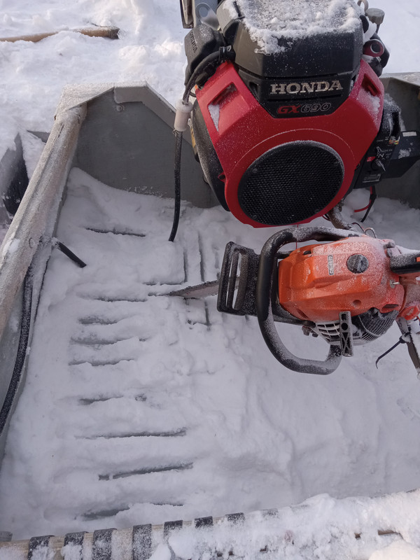

I've clear-cut and bucked up about 2 acres of Alaskan birch with the 4910(cheaper 501p). Took a long time to break in, and was significantly more powerful after a coupla of 10 hrs days of bucking.
On the 4910, muffler is really dented up, it's too thin. The clutch cover is really flimsy. The filter cover is absurdly thin. I can see why they're so light.
The 261 is definitely a tougher built saw with a much nicer magnesium clutch cover and a nicer air filter. Stihl did a great job on the 261.
