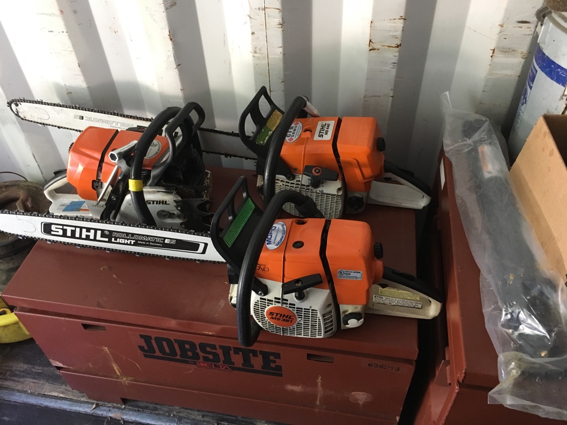

He goes by DRF256.
This is one he did & it’s a ripper.
