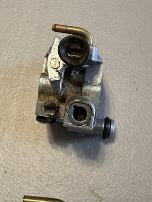

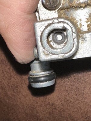

I got what was left of the red limited cap out but the head and maybe part of the screw went flying. This is what is left in the location of the high screw.IMG_4609.jpeg

Might be best the screw is busted instead of the threads being wollered out.
BTW, how did it get broken?

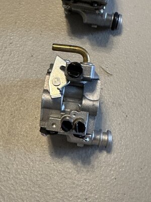

Checked with a couple dealers and found one that had a WT-426B carburetor for $80
It doesn’t have the limiter tab on the high jet. But the low is in a different location. IMG_4615.jpeg

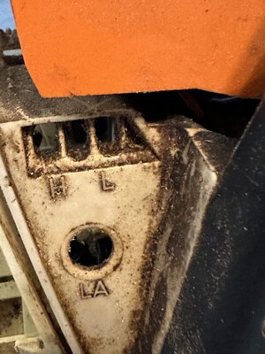

The saw has 3 slots on the case to adjust the needles so still bolts on and can be adjusted easily. IMG_4616.jpeg
