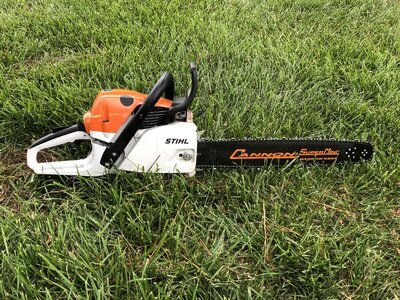

Quick update:
I had to travel a little further but found a .63 gauge bar and chain.
I ran almost a full tank yesterday and it cuts great. I didn’t notice any obvious speed loss in limbing. I bucked about a 16” white oak and it did seem a tad slower than the 3/8lp there but not bad at all. After cutting, I didn’t feel like I needed to hit the chain with a swipe or two, which I generally did with the lp chain.
I’ll run this set up for awhile and give the .50 nk set up later down the road
