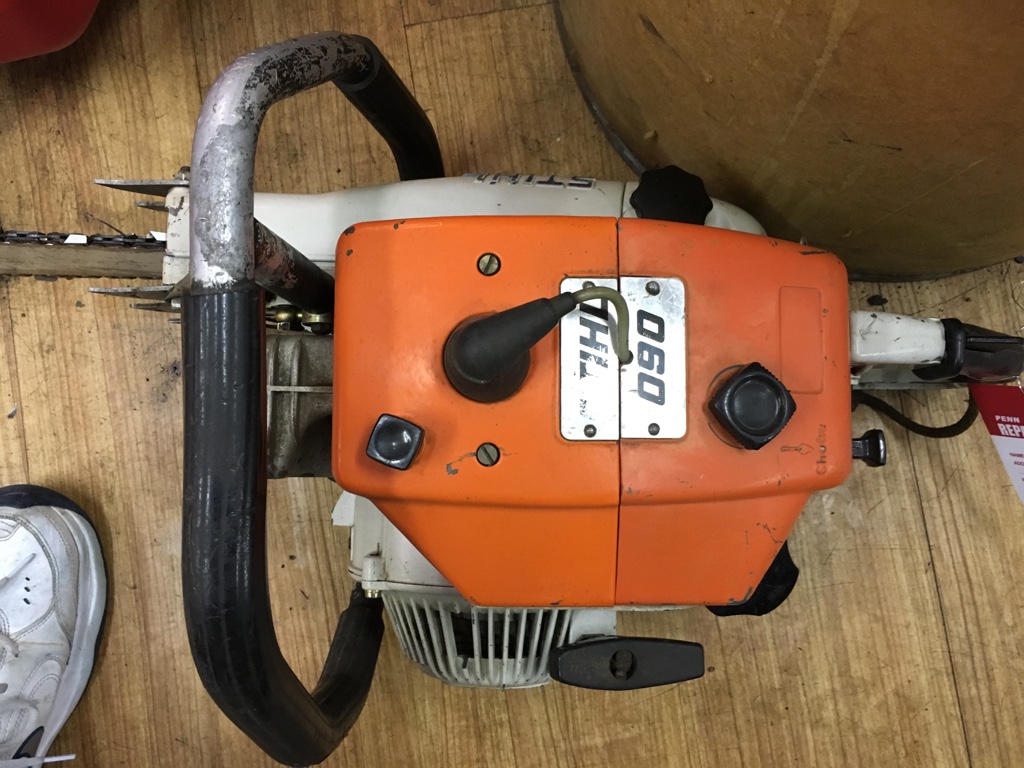

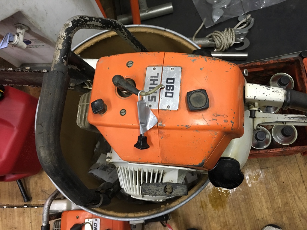

I know where 2 are for sale
I dont know if still available but i can find out i believe he wants good money for them
