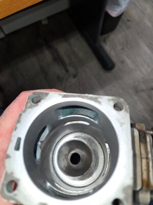

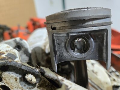

My plan is to first try fixing the ignition and see if I can get it running. I did check the compression last night and for what it’s worth, it was around 152 psi. Through the bore scope, the cylinder looks to be in excellent shape. Not sure what condition the crank seals are in, but the bearings are buttery smooth. Assuming I can get it running, I’ll tear it back down and check the timing and squish on it. I don’t have any illusions of making it a regular use saw, but I also can’t stomach seeing it get junked so I figured it’s a good candidate for practice. The goal is a play saw for occasional firewood use that I might bring out for local vintage chainsaw competitions. If anyone has experience with this particular model or other Stihls of that vintage (045, 045S, etc.) I’d love to hear what you’ve done.
