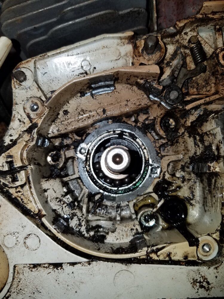

Just as a note to folks, the oil pump does not have to be removed completely to successfully rebuild one of these saws. It can be swing out of the way on it's oil line and left in if there is nothing wrong with it as shown in the picture where I am repairing a stripped hole for the bucking spike, which is kinda common.
