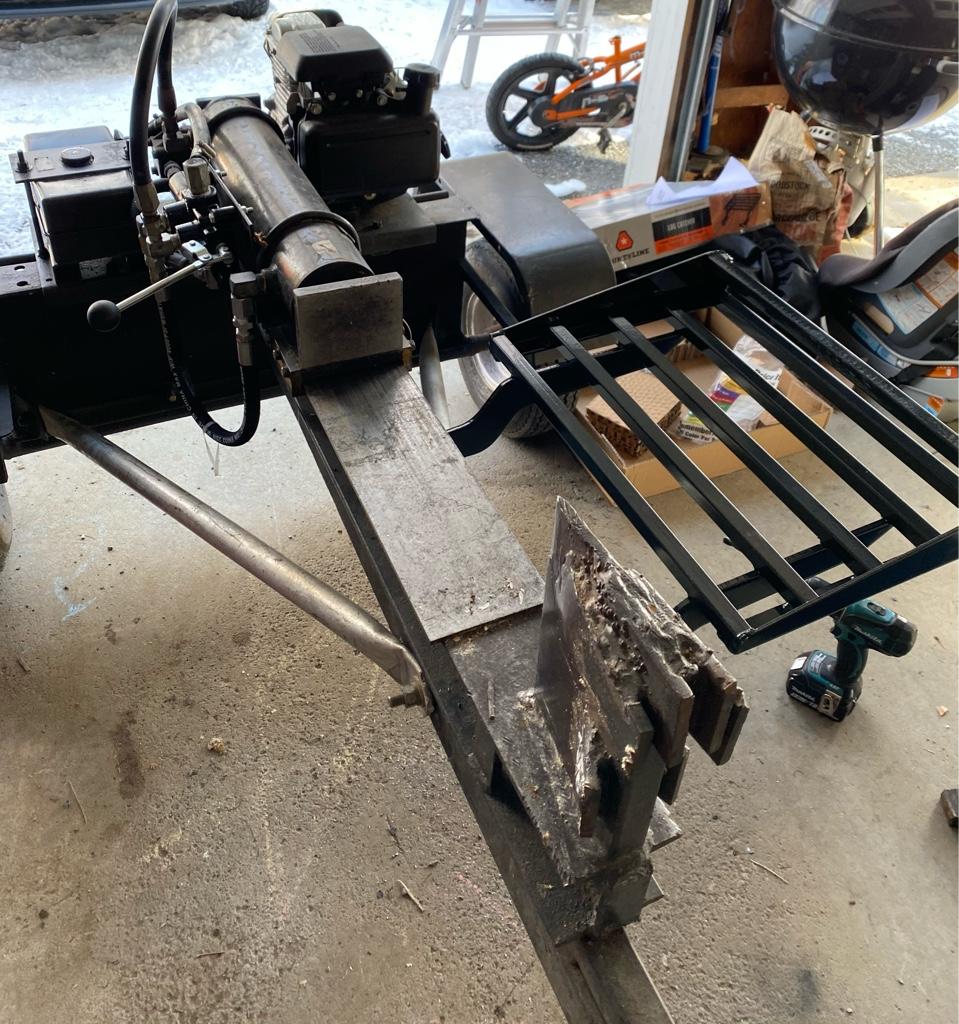

I went for it and drained as much of the old fluid as I could when I changed the valve. I can’t believe how much of an improvement the auto-return valve is. Also added a log cradle and it is like a whole new splitter. I had been looking at replacing it but now am glad that I spent the $150 on upgrades. I am going to keep and eye on the fluid for water but otherwise I think this thing is good to go for many more years.

Here’s a pic with the upgrades.

Do you have a picture of your setup? I am not sure what you mean by work table Before I had the cradle I used to park the splitter next to a really big round that served as a sort of table. I am always up for more improvements. Thanks.
Timberwolf calls it a "table grate" other manufacturers call them "off shoot tables". They handle the off splits so you don't have to pick them up off the ground after every split. Also serves as a transition to the conveyor as well

My mini DR 6 ton electric has the added bolt-on catch table feature. The big splitters get a sheet of plywood between the trailer and the splitter. Bigger the table the better.
Also have the booster table made for the 5 and 6 ton DR splitters. Nothing like a double height mini if your not sitting down on a cut firewood round.

I see what you mean about the table. Like the ones on the Super Split or DR. I like the idea of a plywood table or even a chute closer to the woodshed. The older I get the more the work smarter not harder saying makes sense!
