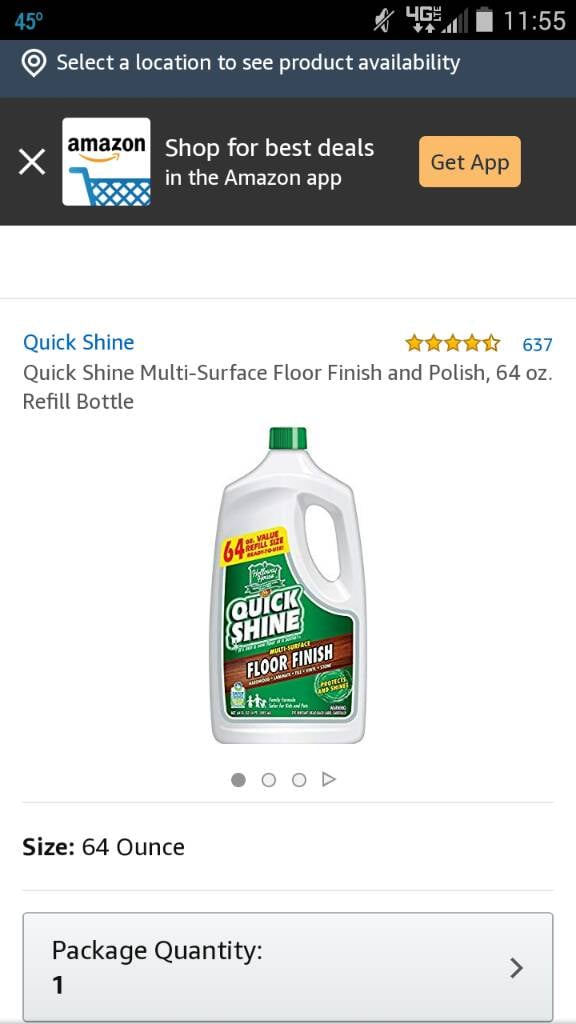

Got the top dyed this afternoon. Had the daughter do my pressure washing, so i could play around with the saw. I promised I'd make hot wings for dinner.
I'm waiting for some plastic polish. Hoping to get rid of the haze in the plastic.
This will give it some shine. There's also a buffing compound that works. I'll get a pic when I get home.

Screen shot...link no worky.
