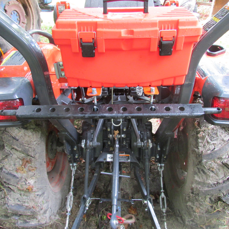

(1. The little thing the gray box on the back the size of a pencil box they called a took box. Put a couple lynch pins in there and it was over loaded.

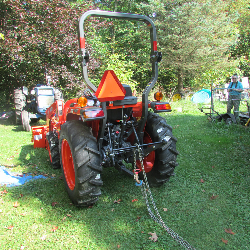

(2. Track is narrow really narrow not any where as wide as a real tractor. Even the old antique Ford 2,8,9 N's are wider. very unstable if you do not have table top flat property. Ran over a frozen chunk of snow when plowing the drive way and puckered up so tight the seat has a perment pleat in it

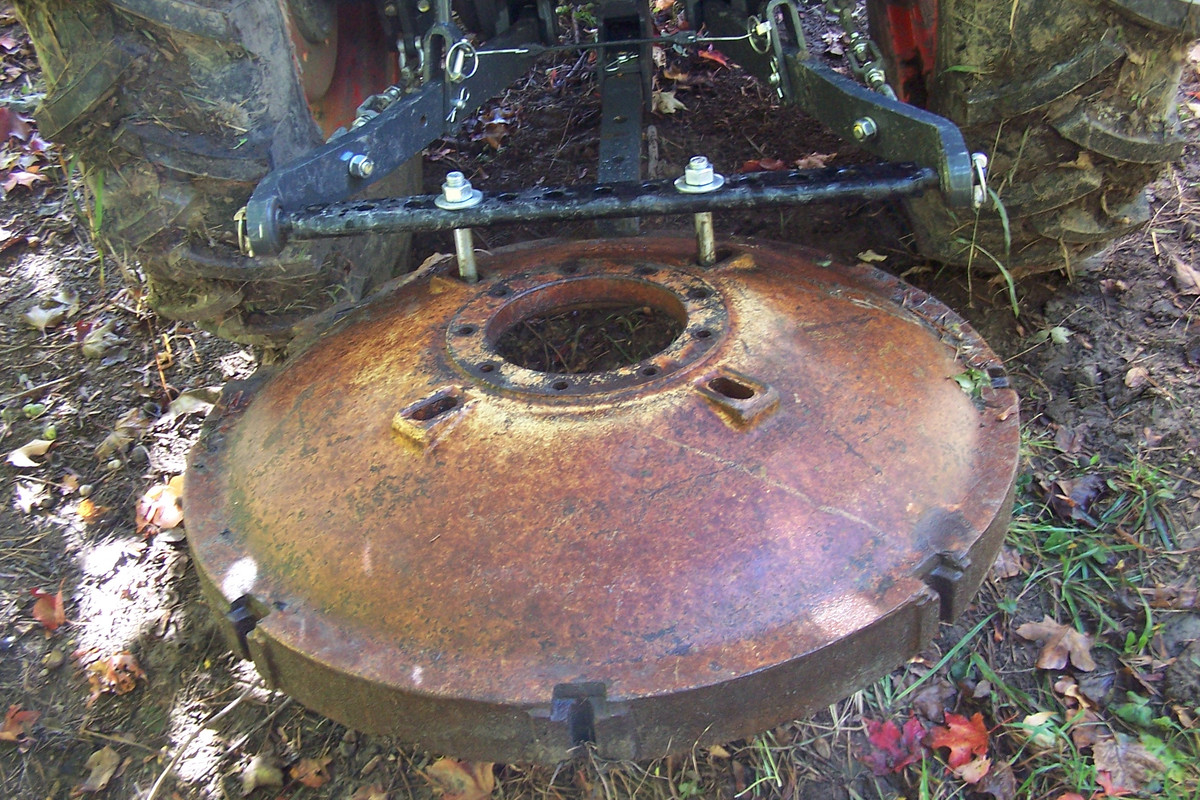

Then note the dish in the rear wheels, you can't just go to a tractor salvage yard and buy a set of wheel weights for rear ballast and the Beet Juice in the tires isn't enough with just a bucket load of dry ASH fire wood crossing a field.
Want to buy wheel weights that fit it? cost about $1000.00 to fit the wheels.
OH you can make a ballast box for the 3 point. then the 3 point is usless for doing any work with a 3 point attachment.

Second thing was to get rid of the pencil box and install a real tool box.
Made the boc brackets a little long to add the J hooks to it. Hang the 3 pt draw bar on, hang lynch pins on when changeing 3 point tools.
Makes the 3 point useless but 385 pounds of cast wheel helps the bucket bounce. and can be dropped easy. I have 4 more i can stack up if need be.

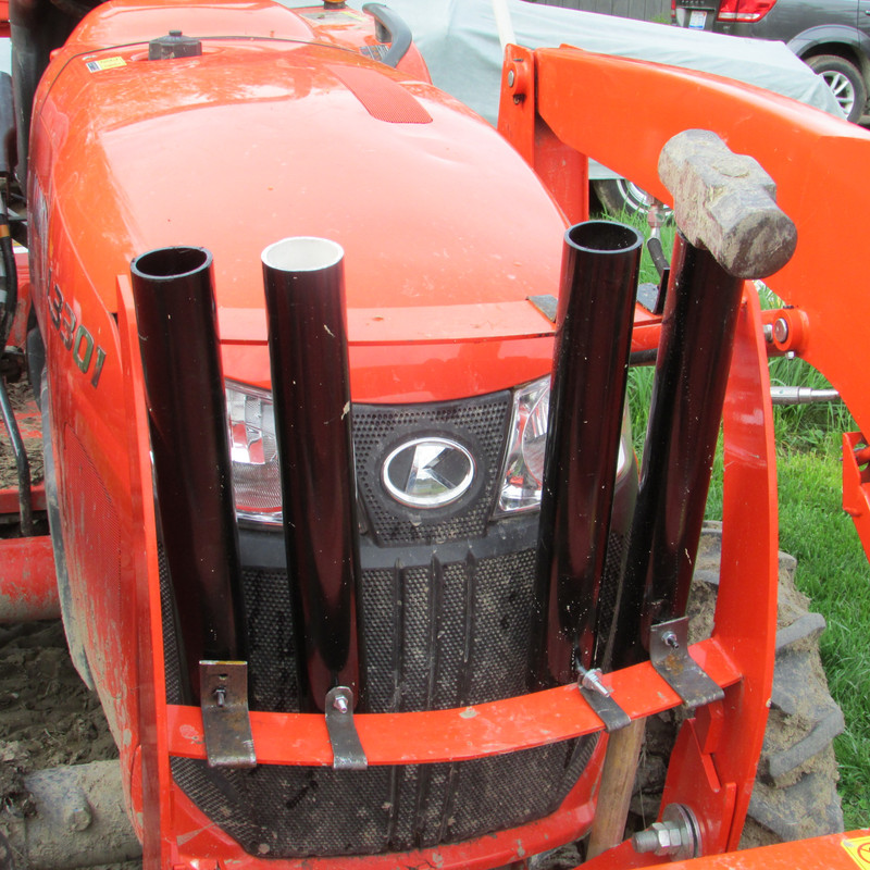

Head lights are useles sif your doing any bucket work after dark. Why not add some place to carry a sledge, splitting maul, a double bit axe a short handle shovel or a scraper to scrap posin ivy vines off trees.
What a ROYAL PAIN IN THE KISTER to change a 3 point tool. Real tractors have a chain that allws the lift arms to sway and be easy mover to hook up.
Compact tractors had turn buckles and you need tools to loosen them up to move the lift arms.
A quick hitch is the answer to fix that mess. or pay as much for carl's claws.
A 20 minute job is reduced down to about 5 minutes to remove and add a 3 point tool.
If you use the tractor to work fire wood like I do you need a place to carry saws. Found a couple spots on the loader frame thr limbing saws fit. and made some for the RoPs for the bigger saws.
I muscled the rear tires right to left and left to right to widen the tractors stance. Still not as wide as a stock Ford N series tractor but better than stock.

Couple things, they do say not to swap the fronts for a wider stance because it increases the stress the loader puts on the front axle. Go to town with the rears though. Also, you can make your own wheel weights with concrete. There's some good threads about it at tractorbynet.com. And finally, I wish your dealer had put you on an MX4700 instead of that L. I sat on an L3800 when we were shopping. The MX next to it was $4000 more, but quite a bit heavier, with bigger tires, a wider stance, 10 more ponies, and double the lift capacity. Everyone who's used it, or had me out to do work comments about what a nice size machine it is, and they're right. Since I've bought my MX, I have recommended them to a few people I know who were tractor shopping. Two people bought them and love them.

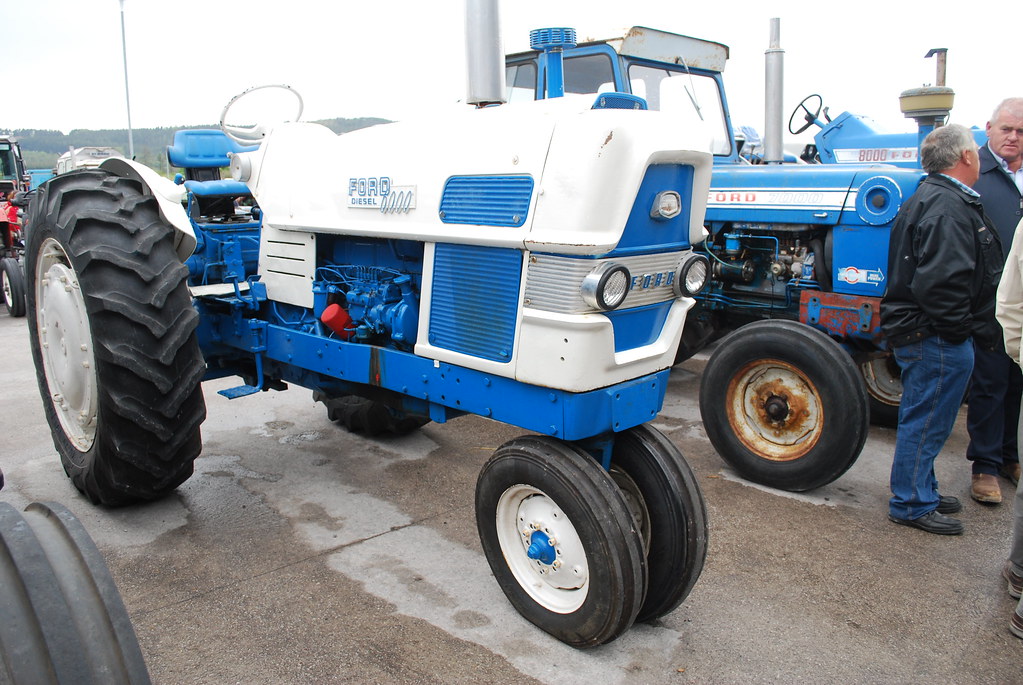

1965 Ford 5000 gas tractor.
Those Ford Commanders made from 1965to 1967. Could be had with a 4.0 liter 6 cylinder diesel engine, or a 3.7 liter 6 cylinder gasoline or Propane engines.
Nebraska tested at 66.93 horse power.
there down fall was the Slect O Shift transmission their longevity left a lot to be disired and were very costly to repair.
Very pricy tractors to buy today as they are rare any left now excaped the scrap yards and fully restored or partly restored.
I couldn't find any thing on when they went from red to blue tractors. the earliest were red.later were blue.
