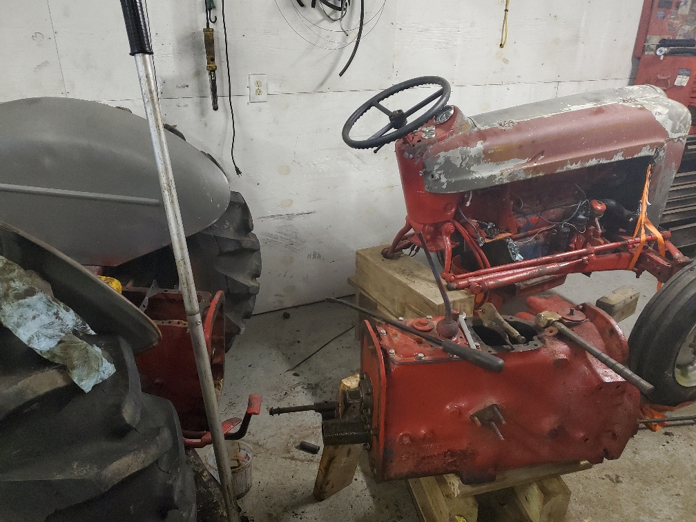

Middle of major repairs

Was there this time last year too. What's wrong with yours?
The pressure plate let go and the hydraulic tube that goes through the transmission had a few pin holes. Would empty the hydraulic chamber into the transmission.
