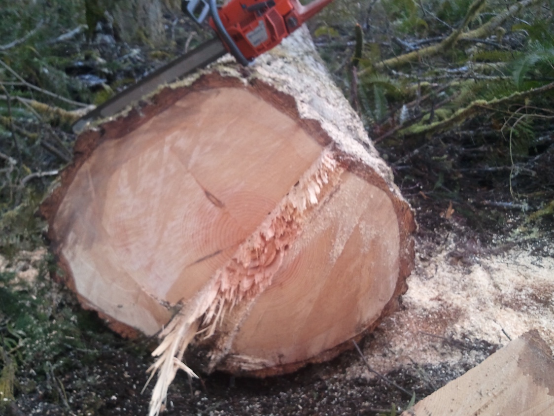

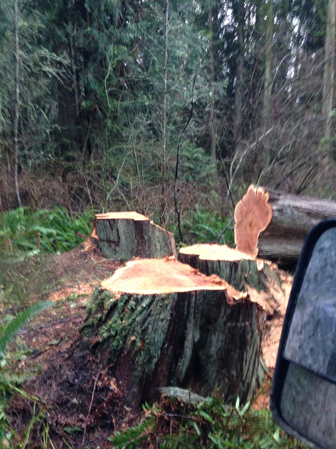

Here is a stump pic of an alder ,this one my side cuts nipped the hinge ,on bigger trees this is ok ,smaller try not to cut the hinge sides ,this one was about 20 inches across i think ,make a shallow face ,humboldt prefered (Face cut downward ) then from the sides nip the sides at an angle making the triangle ,do not walk behind a leaning alder ever when cutting i will add ,they blow out easy .once the 3 cuts are done ,make the back cut ,(I was trying to chair these trees so when it started popping i let it go to see if they would ,they just pulled the guts out ) the reason the sides are cut is to relieve pressure in the sapwood and getting you into the stable heartwood ,these trees were leaning about 2 oclock on a clock for angle ,if look at the stump picks can see the triangle and back cut .(Note if tree is hollow /rotten ,don't use this cut ,bore it )coos bay cut alder 026.JPG coos bay cut alder 027.JPG coos bay cut alder 028.JPG

Here is a stump pic of an alder ,this one my side cuts nipped the hinge ,on bigger trees this is ok ,smaller try not to cut the hinge sides ,this one was about 20 inches across i think ,make a shallow face ,humboldt prefered (Face cut downward ) then from the sides nip the sides at an angle making the triangle ,do not walk behind a leaning alder ever when cutting i will add ,they blow out easy .once the 3 cuts are done ,make the back cut ,(I was trying to chair these trees so when it started popping i let it go to see if they would ,they just pulled the guts out ) the reason the sides are cut is to relieve pressure in the sapwood and getting you into the stable heartwood ,these trees were leaning about 2 oclock on a clock for angle ,if look at the stump picks can see the triangle and back cut .(Note if tree is hollow /rotten ,don't use this cut ,bore it )View attachment 159957 View attachment 159958 View attachment 159959
