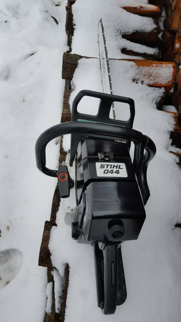

044 super magnum, brand new 36RS chain, green elm.
Showed this 044 to @Sarahdodgegeek last weekend, she said that's a made up saw....
LOL, made up my ass, seeing is believing...
Look at the sticker on that thing!!! Super magnum.. ya right. Totally made up. [emoji12]

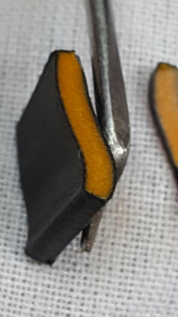

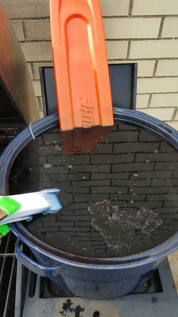

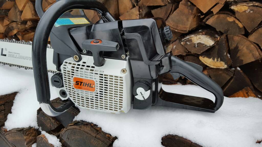

What did you use for dye? I had no idea you can dye plastic. Fine looking saw you got there.
I used Rit clothes dye. That was suggested by hedgerow. Two bottles in about three gallons of water on a slow simmer. I did it in the side burner in my gas grill. The orange plastic took the dye really well and was finished in about an hour. I let it go longer for the heck of it. The white tank took a lot longer. I bet I had it in the pot for at least four hours.
