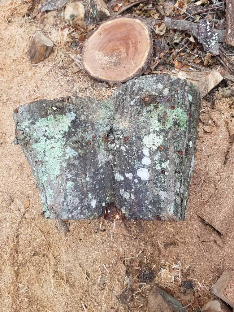

Here is another video with my .325 square filed chain and a video with .325 round filed semi chisel for comparison. The .325 square is not perfect by any means, but I am getting better at it. It cut very smooth to me and I like it.
.325 square file
.325 semi chisel round file for comparison.
Another video with square file .325 cutting red oak crotch.
Lastly, Stihl MOFO 460 running 24" 3/8 full chisel round filed chain cutting a red oak crotch. This saw is mean and angry at the same time. Chain is brand new out of the box Oregon Full Chisel chain. I did not lower the rakers, although it does look like I did in the video. Saw is super strong and does nothing but pull hard! [emoji106]

The chain wasn’t aggressive on the 460. It was the dogs. Most large dogs are too much in hardwood. That’s why they put the smaller ones on east coast saws I believe. Some of the large dogs are better than others in hardwood. Maybe try the stock 660 dual dogs on it.
