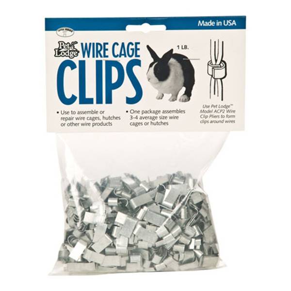

Not sure what the yellow handled punch is for. Sorta seems like some type of unrelated crimping tool
It is a cage clip installation tool for making cages out of welded fence wire. Things like chicken, bird, and rabbit transport cages is some the ones I have make with mine.
These are the clips that it is used with.

Looks like a nice tool.
