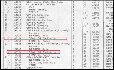

Does anyone know what aftermarket seals are used in the PL5?
I know that no one is reading my posts here,but I'll ramble on anyway.
Going by what @pastryguyhawaii just posted, if you can measure your seals and compare to the dimensions above it may end up being it! I just picked up a PL-5 from an auction and have not torn into it yet, though it looks like it is complete and in pretty good shape. I am sure the carb and fuel lines will need to be redone - heck if you confirm if the above seals will work, I might go ahead and replace these too. Here is an image of the original part number, not sure if you might get a luck google search which might turn up a cross reference to an AM seal that will work.

Now let me get this straight ..You're looking at OEM number 65194 ? If so give me an hour or so when the sun rises I'll get out the master interchange book and take a look see .It's still o dark 30 here .I get up before the chickens most of the time .

The
Remington RM-1 (Part #65194) oil seal
, designed for older models like the SL-11A, SL-4A, and PL-4, typically features an inner diameter of 1 inch and an outer diameter of approximately 1.378 inches (approx. 25.4mm x 35mm). It is a specialized, often discontinued, part used for crankcase sealing.
Key Details regarding the
Remington 65194 (RM-1) Seal
  • Part Number: 65194 (often referred to as RM-1).
  • Application: Crankcase oil seal.
  • Fits Models: Remington SL-11A, SL-4A, PL-4, and others.
  • Dimensions: Usually 1" ID x 1.378" OD.
  • Availability: Primarily found as "New Old Stock" (NOS) from specialized vendors like Chainsawr.
