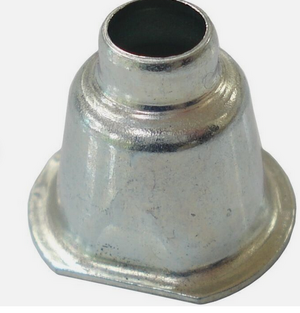

What is the proper way to replace the rope bushing on a Stihl starter housing? Basically how do you guys go about crimping it back in with out it looking hack or damaging it and having it wear the rope worse than the original worn through one? TIA

This thing, in case I used the wrong terminology.

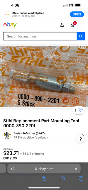

Makes perfect sense. Was debating about doing something similar until I found the tool for $20 this morning. Now I have another tool I'll probably use less than a dozen times. But hey I'll have it...

They make this tool, I’m sure this is the one you found. It is pretty easy to make one from a countersunk socket head cap screw and a spacer. or if you have access to a lathe.

Yes that's the tool. I may try the counter sunk cap screw method while I'm waiting for it show up though. I want to use that saw this weekend but I don't want to buy another rope next Tuesday.
