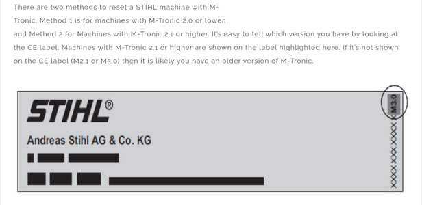

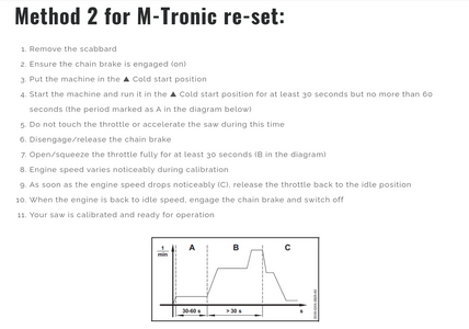

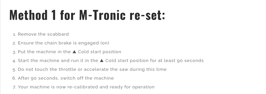

I believe it’s 90 seconds in the choke position and without touching the trigger turn the switch to off. And then start the saw back up and make 5 consecutive cuts.
The second method is the calibration that is used on V3 MTronic, and I’m relatively certain yours is older than that
