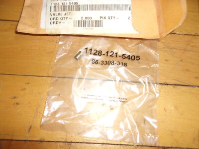

I have an update on all of this. I ordered two new nozzle/check valve assemblies for my saws and installed them on my HD-14 and HD-16. Lo and behold, the fuel puddling issues are gone. Idle fluctuations are gone. Throttle hesitation is gone.
If you are having issues with your HD series carb, try a new nozzle.
I have seen Walbro’s black rubber check valves swell and plug the nozzle due to ethanol exposure, but I can’t recall ever having issues with the tan Mylar ones.
It is absolutely necessary for that to be present and functional for the saw to idle correctly
If it isn’t working, air is pulled back to the metering chamber at idle. Thankfully, a non-primer system doesn’t need a check valve on the idle circuit. Zama trimmer carbs have too much trouble with the idle check valves, which are non-serviceable (pressed into a blind hole under the metering lever).

Here is a video I made for another member who was helping me diagnose this carb. You can see the hole where the nozzle was. It must be aligned in the correct orientation when punched back in. I just use a regular tapered punch and a hammer. Set the carb body on a block of wood so you don’t damage it.
The check valve in the nozzle can be pressure tested. Simply push pressure into it from the Venturi side and see if it holds. Make sure the recessed interior hole is free and open to the atmosphere to allow leakage to present itself if it is present. See my video. This is how I diagnosed the check valve in one of these saws. Some do not leak as extremely as this one did, but still need to be replaced.
Pressure testing nozzle/check valve.
