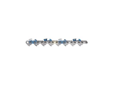

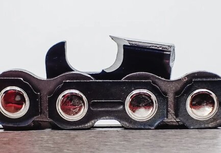

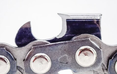

Looking at different chains and one thing I have never learned much about is the raker profile.
These two Dukes models have very different profiles.
What affect does the shape have on cutting?
EFSM
6:11 PM
29079
Apr 30, 2024
1,327
3,195
Extreme southern IL
Some of the difference is for kickback control. For instance, Oregon’s LGX chain has no bumper drive link, the LPX does. It is also for vibration control. Pic of .325 LGXIMG_1008.jpeg
View attachment 483677View attachment 483678
2nd pic is like a 30+yr old Stihl chain…was great stuff back then. We preferred it to newer offerings due to less material to have to remove as the chain wore down. Less time with the raker file…

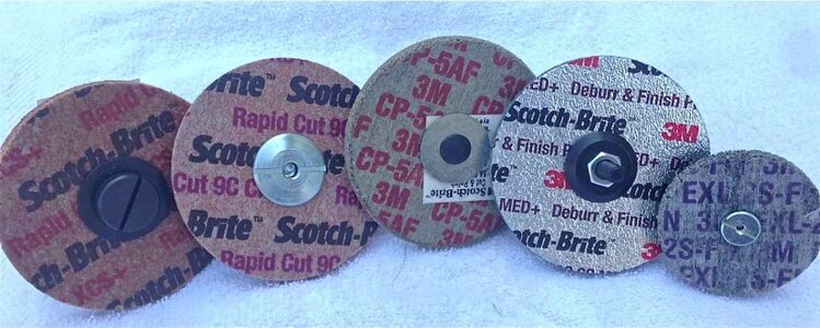

I prefer to restore the depth gauges to factory profile, to minimize the risk of a sharp corner catching.
Use a flat file, Dremel, or Scotchbrite abrasive wheel (my favorite). Some guys profile their deth gauge wheels concave, to save a step.
