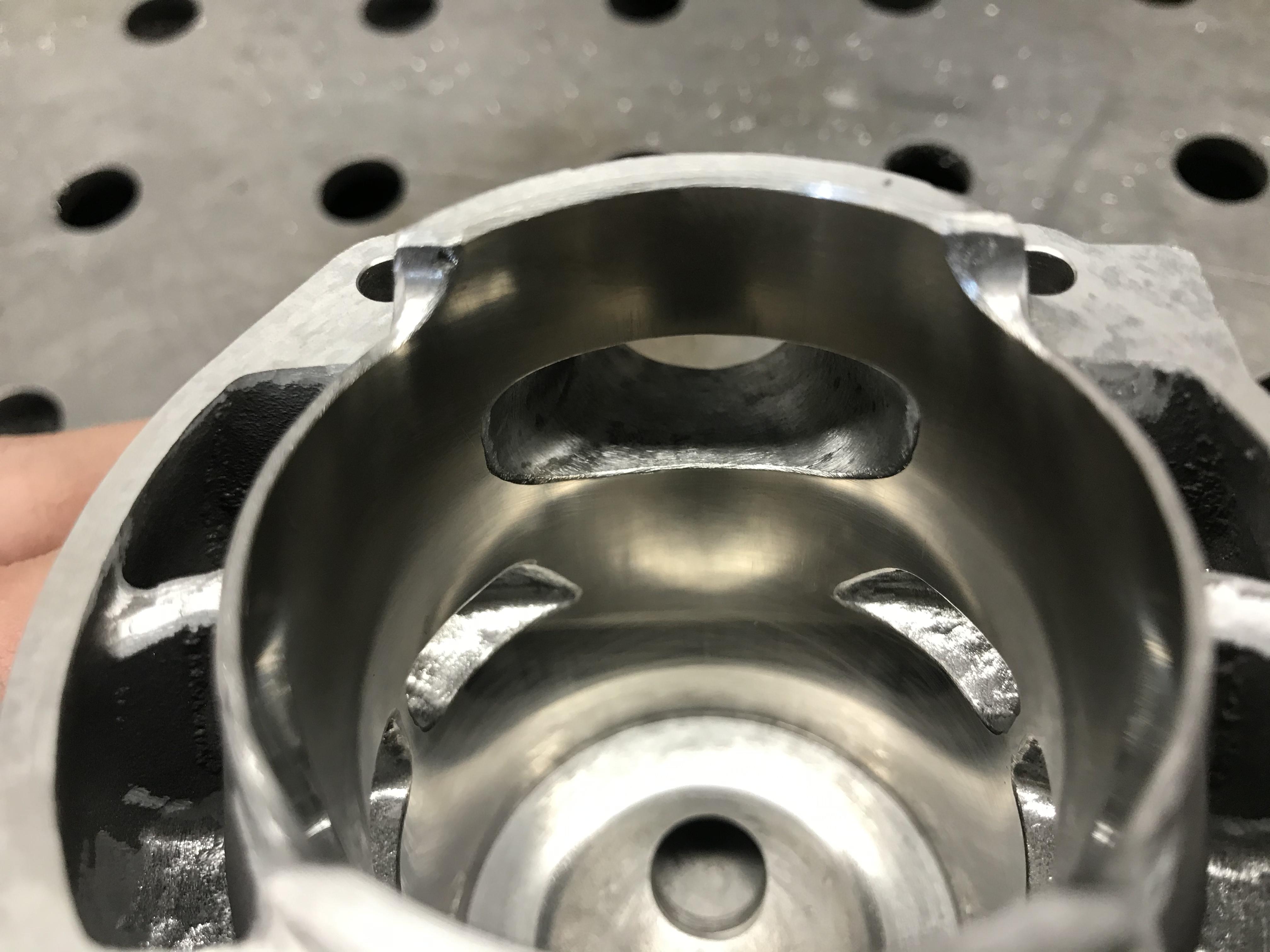

562XP Lowers. After I took these pics I went ahead and did the uppers, I rose them about .020”. I had to measure the port heights in the cylinder instead of using a degree wheel because I didn’t have a piston stop. Took .019” off the exhaust.
After I dropped the base gasket I had to shave the piston with a belt sander. I took like .030”off of the piston which set me right at about .020” squish. Didn’t touch the exhaust after I did the delete because I figured the timing would be about the same since I shaved the top of the piston. I could be wrong.
And I also shaved the skirt with the belt sander as well and smoothed everything everything up with some 1500 grit sand paper.

6F1C5315-D6EC-4EDB-9738-0F323F81EDBE.jpeg 359XP . Didn’t raise/ lower anything just made the exhaust port larger, messed with the lowers a little bit. Sometime soon I will get a piston so I can time it and go further with ze porting.
And if you guys have any suggestions on what I should do, let me know. I am always open to advice:).EF186C15-DF61-4C77-ADA6-8474AB0F8591.jpegA15F62C7-043B-477E-8CE9-E39BBEDE65A3.jpeg
