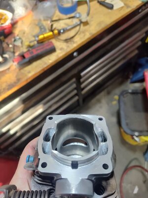

Got my first attempt at raising transfers coming up soon, without an angle handpiece to make it more tedious than it already is.

Been tempted to do that. Probably will if I fubr this little 026 44mm with little cutoff wheels on a straight foredom.

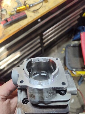

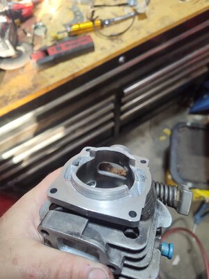

Looks like you got it done with the cut off disks. Now just to see how it runs
Yeh, they worked very well on the sides, roof was slow going but I was raising it 10 degrees. 90% of the work was cutting base, squish and piston.
Will see how it runs tomorrow.

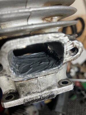

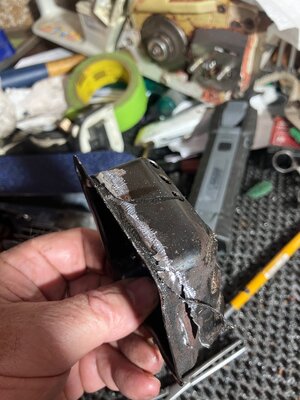

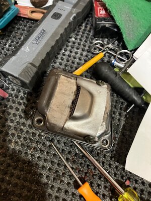

Dealing with a few little things. Janky on/off switch, stuck chain tensioner, muffler mod, .060 of freeporting.

I wouldn’t worry about free-porting on the bottom. Anyone that’s done it says those are some of their better running saws. It’s better than JB weld flaking off the floor
Good to know. I'll run it without it and leave it as is if it runs well. At some point I'd think there could be too much. How would the saw run if there was too much?
I don’t really know that it’s a thing. With a big enough hole in the muffler there’s not much back pressure to speak of 🤷🏽‍♂️
