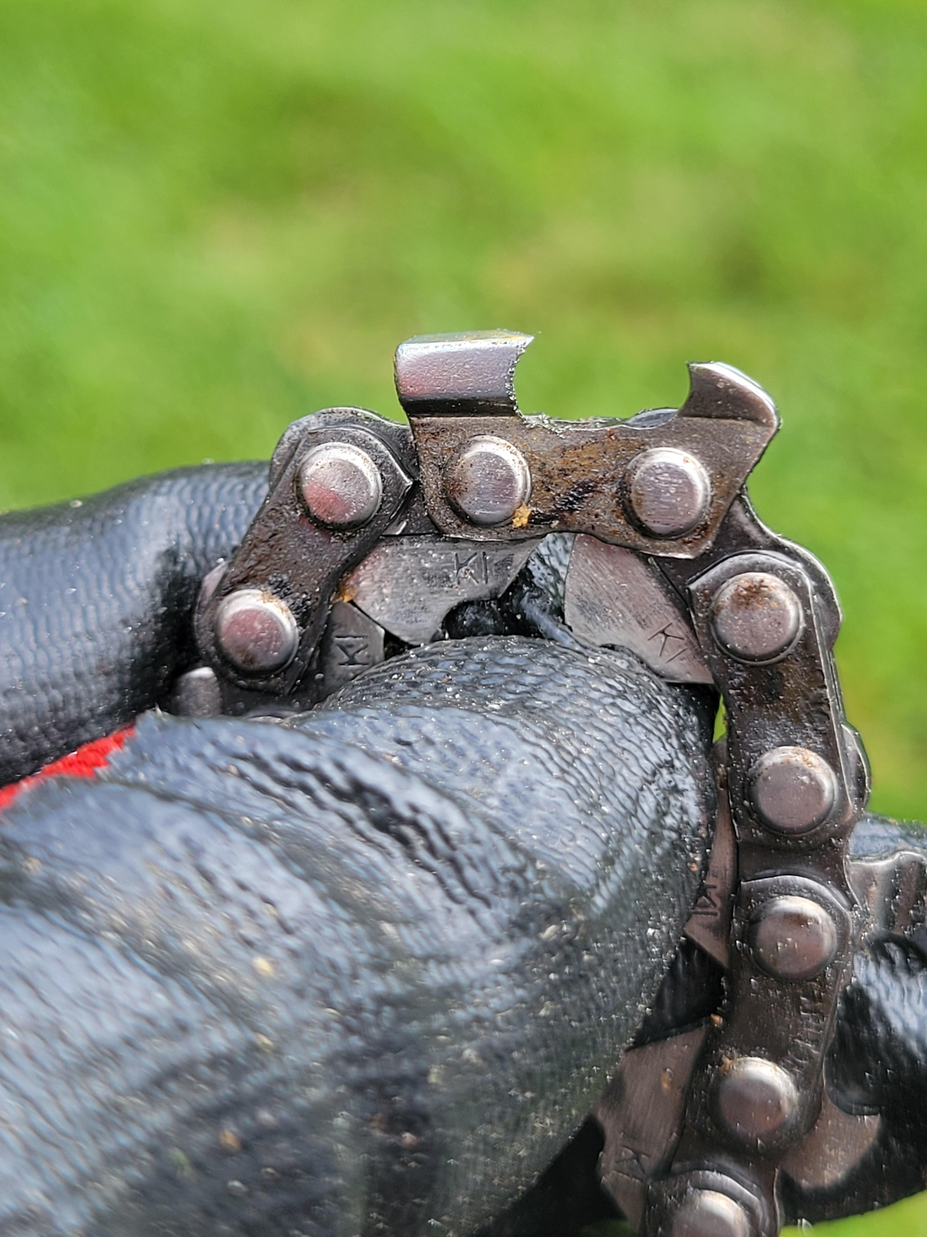

Looks good Tim. I personally take a bit more out of the gullet. Right at the bottom. The wood will tell you for sure.

Just found pics of the Carlton .325 chain that looks similar to your chain. Very low cutter. I actually cut into the strap a little.

That's exactly how they should look. Nice C shape profile from the cutting corner down to the gullet. If you run a straight line between the two points it should be just about vertical.
Nice opened gullet for increased chip flow.
Sometimes one has to switch to a smaller file to account for the decreasing vertical tooth height.
All in the trial and error process, settle on what cuts best for your application.

Nice job Tim. Big chips there. Cuts well. Still cold up your way too I see.
