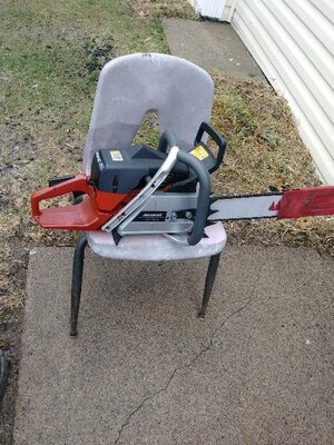

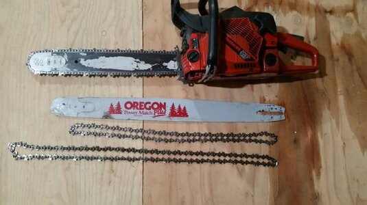

When I bought my non EPA 2065 it had a 20" bar n chain on and came with a 28" Oregon Power Match Plus bar and chain.
I only used it to fell 1 big hollow burr oak that split apart on landing so no need of long bar. Set it aside until today. I bought as a builder but runs strong so haven't dicked with (much) it yet.

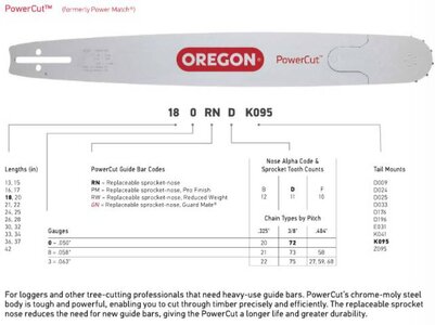

Fired up today then inspected the bar for numbers to order a spare chain.
Oregon EX 288XXXd009
Took a long time to find the decode chart showing where the 2nd 8 represents.058

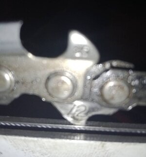

The chain drive links are #72 which is .050 not .058 which are #73
So there ya have another ah ha moment. Explains the scratch on the bar that appears to be from a pinched chain jumping off.
