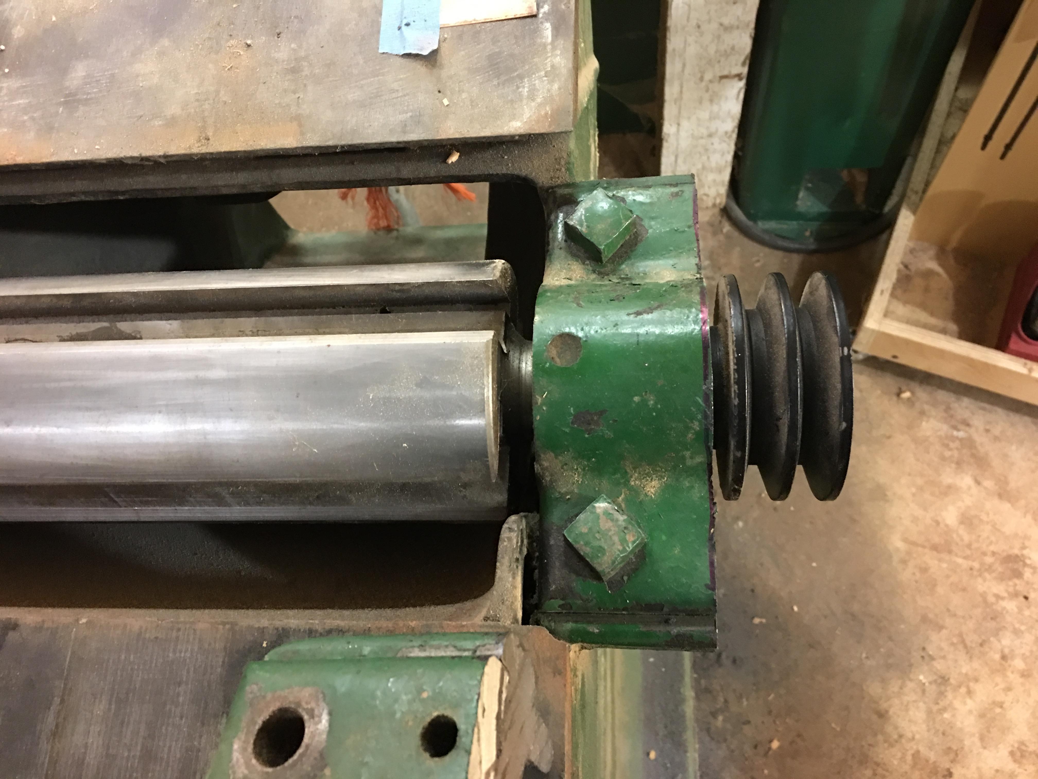

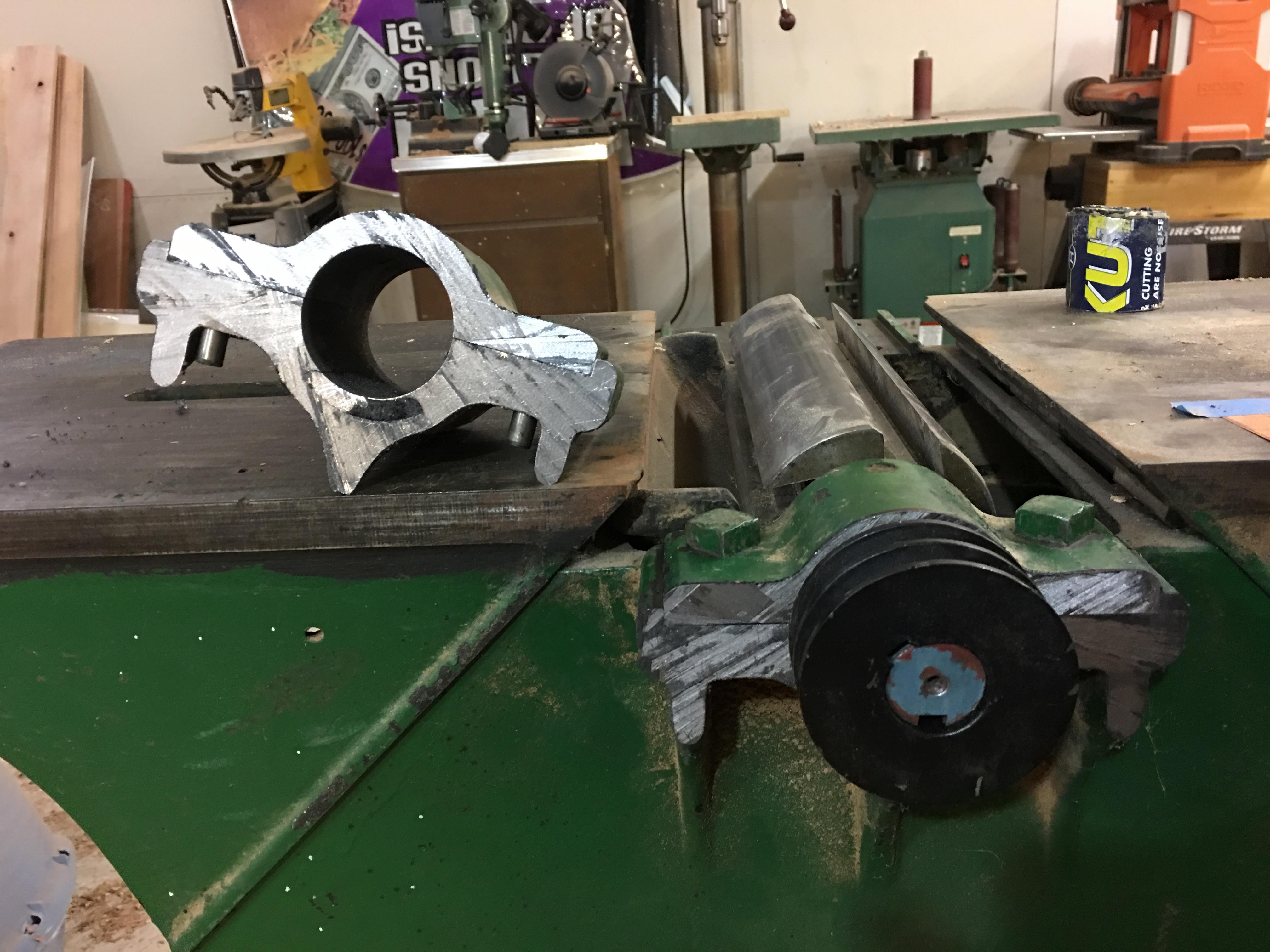

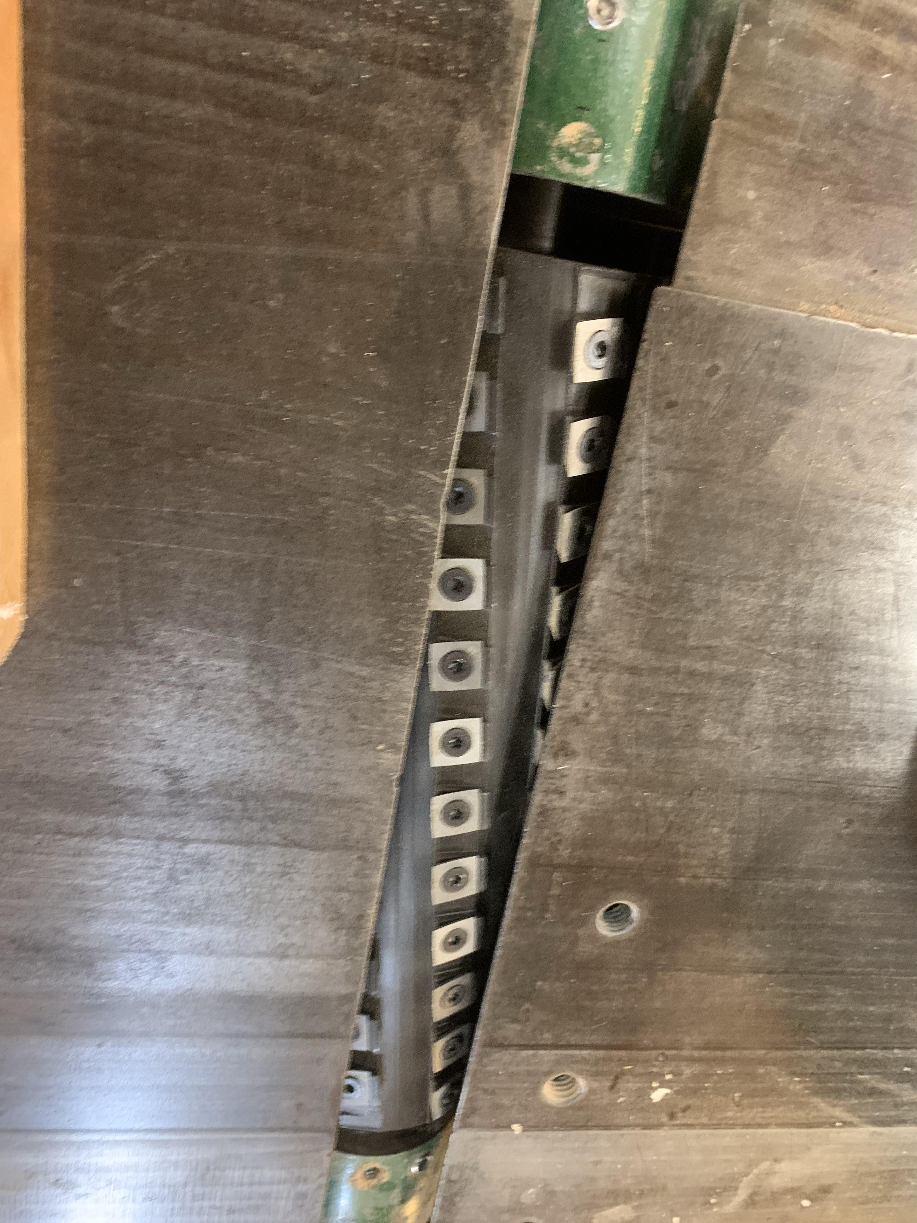

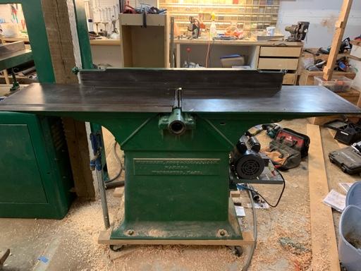

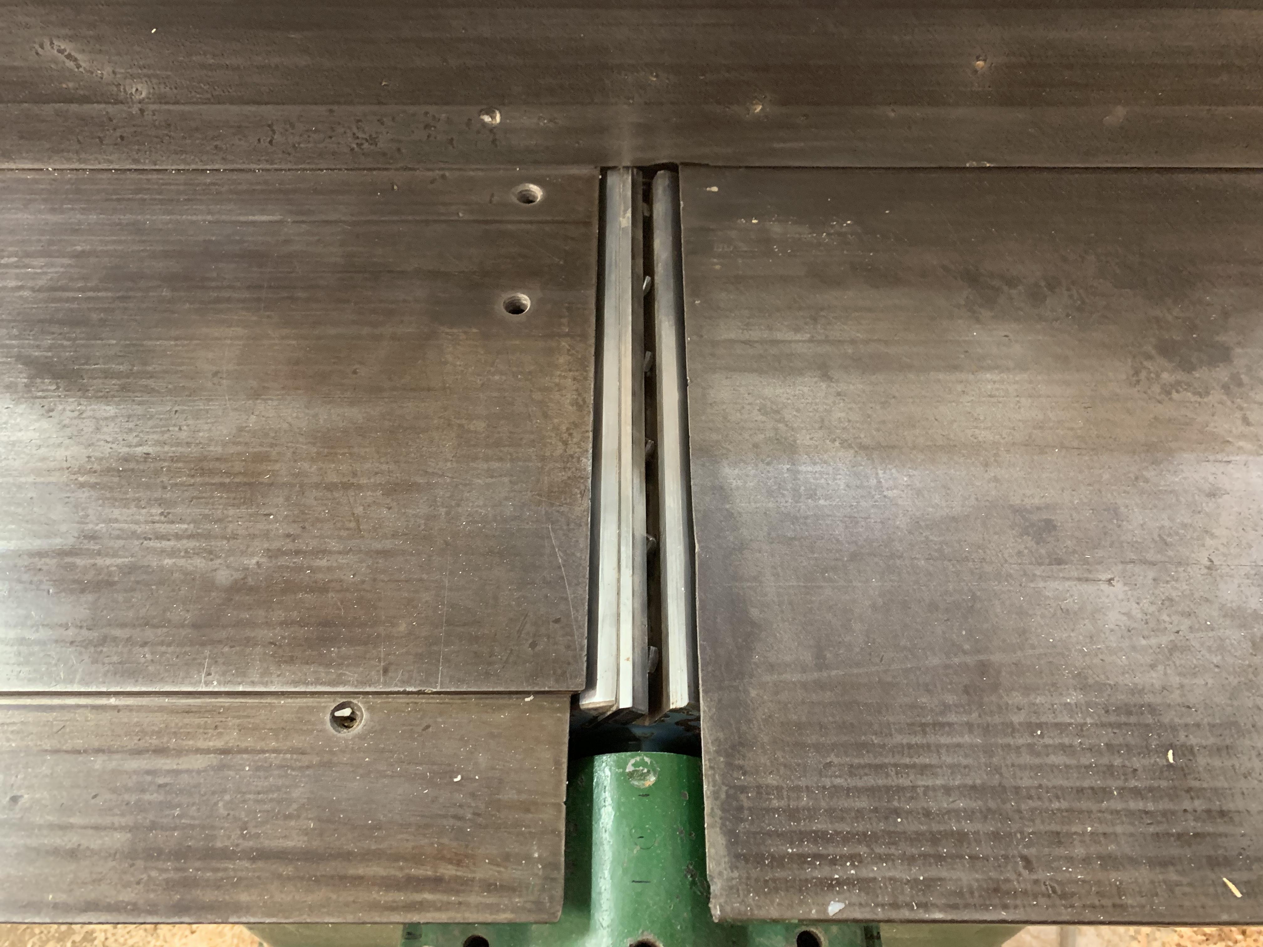

Not really a “restoration” but a rebirth. Bought this 12” jointer for like 100$. The company hasn’t existed since 1910 ish I believe so this jointer is 110-140 years old. Oh had an enormous cutterhead with only two knives. The motor was long gone. Tables were flat and had all the modern adjustments.
I wanted to swap out the cutterhead for a more efficient one so I had to remove a bit of metal from the rear clamshell. I also had a machinist make bearing sleeves that would hold the new cutterhead into the clamshell design.
The cutterhead was a used Craigslist find and I eventually upgraded it to a segmented version.
Of course had to add a motor and way to tension it. I also modified the dust chute to connect to my dust collection pipes. Only thing left is a belt cover but I doubt it ever had one and I’m the only one that uses the shop so not worried about it for now.
I’ve run thousands of board feet over this thing off my sawmill. Old American iron [emoji123]

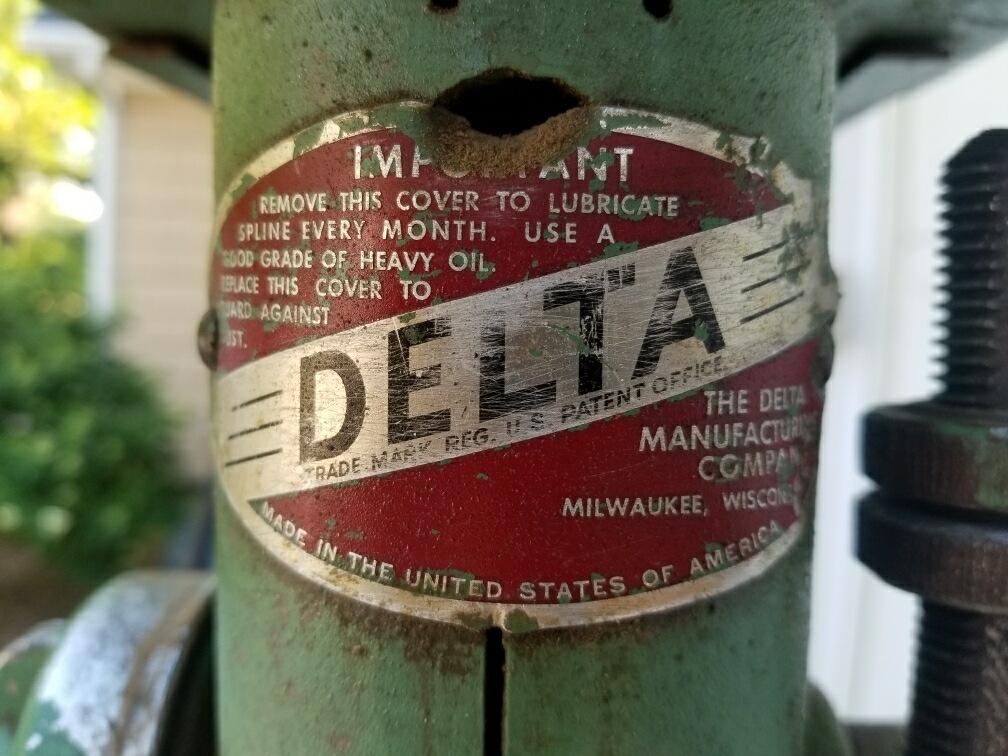

I’ll put up a picture of my old craftsman drill press, buddies grandpa bought it new and it was unused in his basement for 40-50 years. Never had a lot of use in general or heavy use he used to build watches some for fun I guess
YH
This is from the 40’s too.
Kinda cool. Came out of a small machine shop locally. Been there the entire time. She has been used and abused
