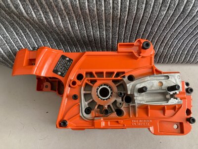

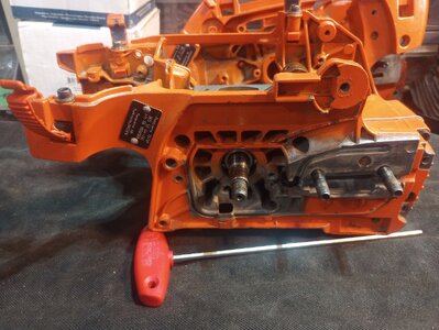

Besides that, I'm going to wash the two new chainsaw projects, it seems the one I know the least about is a 234SG from 1983 (my guess), if so it's going to be a very long project since I have very little else, like a top end lol, but it was missing from my collection.
Sounds like a fun project, don't feel alone, I am still on the hunt for a 357xp top end that doesn't cost more than the whole saw.
Did assemble the bottom end, probably bag it up and wait now.
Yes I heated the cases to let the new Nachi bearings go in easily without any side tension.

08 bottom end. Vewwy nice.
I haven't started yet, step one is to pop the original bearings and install the 372 xtorx bearings, the goal is more of an experiment than there being any sense behind it all.
I have another one that is not as nice, that will get the same bearing, I will deliver it to a bunch of line cleaners and ask them to use it as often as possible.
Check the serial numbers on your project to my 357 project Steve, it's close.
I would assume we can talk a little more freely in this thread than other places on the forum, I mean, those who cold press crank bearings into magnesium housings (and often without a centering tool), are stupid as hell.

Have split the 234SG crankcase, from January 1983, will get new crank bearings even though it's a great crankcase, one-off build this.
Might as well bake it together with the 357 crankcase when it gets 372 bearings.
For some reason Husqvarna has a 242 crankcase and gas tank lying around, I don't know how many but I've bought a set, it's so expensive that it'll stay in my parts collection, maybe the ultimate build when I'm a real retiree.
The only thing that might be a bit hard to know is whether it's a 238 or a 242 crankcase since the Husqvarna fools had one part number from 1986 until 2001.
