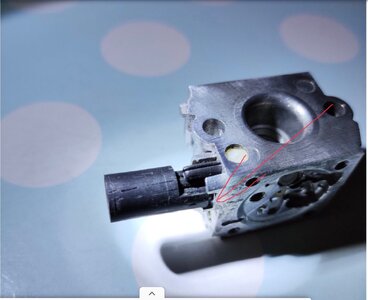

Hi all,
I've rebuilt the case (block?) on an old FS80 strimmer (as they are called here in the UK) and it's all super air tight but still running like a dog, so have now started on trying to rebuilt the original Zama S63A carb (though i did have a brand new chinese carb on it and it still ran badly, so am a bit puzzled) but don't really know how to get the high screw out so i can soak the whole thing in acetone. It's blocked from turning by the split pin which i suspect is 'resined' in with plastic of some sort (the white bit above it in the pic).
Anyone ever got one of these out?

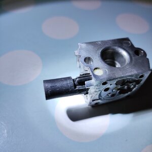

Not sure, but the black plastic on the screw is a limit cap. Try prying on it at the arrow.

The pin is pressed into the carb body. The white insert is probably a friction plug that presses against the needle.

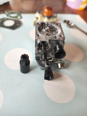

Hi, guys. Thanks again for your help. You were spot on re the H screw limiter. I'm now going to leave it off so I can tune how I want and can take it out in the future as it was terribly gummed up. The main prob with the carb is the main nozzle was blocked and the check cable wasn't working either so I'm all was a mess. Hopefully have cleaned it all and sorted but had to punch out the Welch cap without a replacement so have sealed it with more nail varnish.... Will see what happens shortly.17529411100352652249525157399400.jpg
