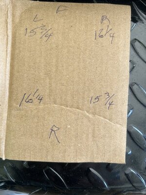

Hi all, I bought a brand new single axle 6x12 trailer several hours away from home. It was stored in a field with many more. When I got home I noticed one side sits about 3/4 of an inch lower than the other. It’s a New Generation brand and is welded nicely and seems well built. I crawled under and everything looks ok, Leaf springs look the same. Will this cause me any problems? I really don’t want to do another 5 hour round trip if it won’t cause me any trouble. Thoughts ??

Tire pressure the same? Parked on a perfectly level surface?

I did some more measurements

Im no expert that's just my humble opinion. I have a 6 x 12 trailer that I had built by a local guy (T&W Trailer) back in 2002. I have never measured it, I don't have a level place to do so. I have hauled many loads on it including some thay were way over the 3500 lb axle limit and never had any trouble except for a blown out tire. As long as you are happy with it, I'm sure it will serve you well.

Likely got torqued when they welded the corners. Not enough tack welds to hold it square. Could put a heavy load on it and jack up the low corners
